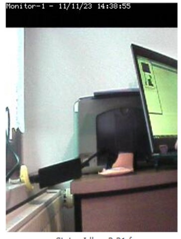

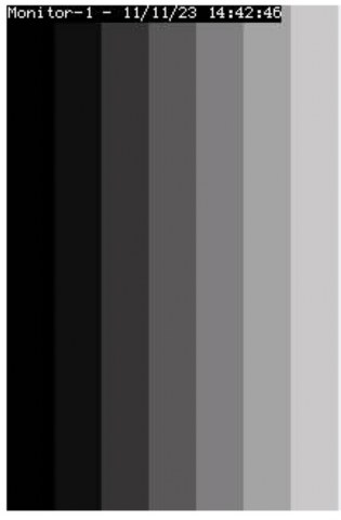

I think i have similar problem, when i plug one camere on my easycap there is normal picture and it works fine, but when I configure camera two on easycap then picture starts to jump like on attachet picture one and two and after a minute i get a screen like on attachet picture three. I have fresh install of ubuntu server 10.10 and zoneminder 1.24.4. And I can't get it work :?
Any solution, please?

Did you disable Options::Config V4L_MULTI_BUFFER value? I'm not familiar with "easycap" but maybe try changing "CAPTURES_PER_FRAME" to a value of 2. Worth a try anyway.

Didn't work :cry:
zmwatch.log has an error:
12/07/11 15:03:20.239226 zmwatch[1548].ERR [Shared data size conflict in shared_data for monitor Monitor-1, expected 328, got 316]
12/07/11 15:03:20.241191 zmwatch[1548].ERR [Shared data size conflict in shared_data for monitor Monitor-8, expected 328, got 316]
any idea???
TNX!
