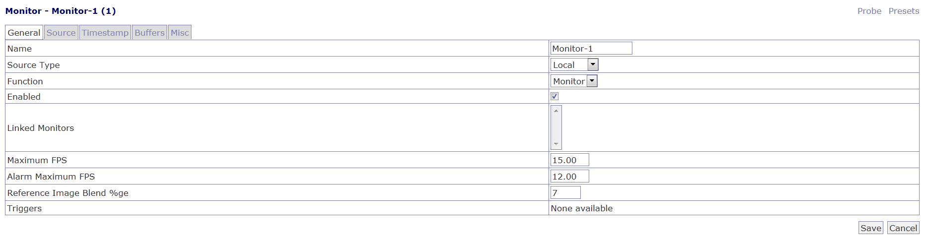

Screen caps of my settings are attached.
If I click "Probe" I get:
Can't parse command output 'd:/dev/video0|D:uvcvideo|C:USB 2.0 PC Camera|B:usb-0000:00:11.2-5|V:1.0.0|T:0x4000001|S|F:YUYV|B:640x480|I:1|i0:Camera 1|i0T:Camera|i0S:0|i0SP:1|i0SS:1|i0SC:1|i0HP:1'
I would appreciate it if someone could guide me through the process of getting it up and running.

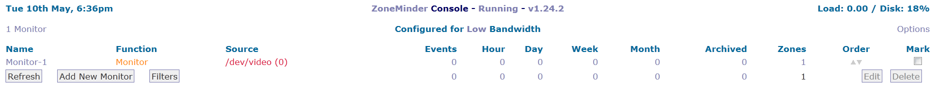

Have you tried changing 'dev/video' to 'dev/video0' as device for your camera in the gui-settings?
gowrath
Joined: Wed May 11, 2011 1:12 am
Re: New install on Ubuntu Server
Post by gowrath »
Whoops! :oops:
I changed it to /dev/video0 and now when I probe I get:
