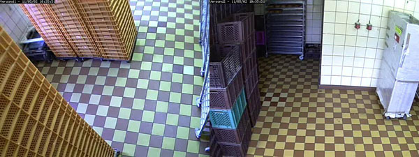

2 cameras merged into one!

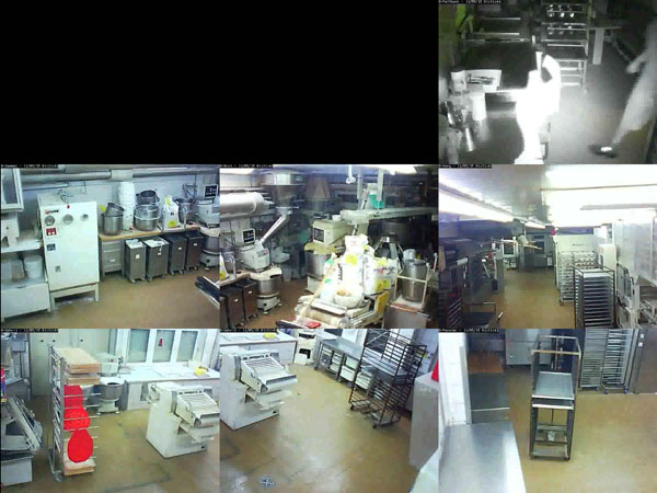

9 cameras merged into one!
