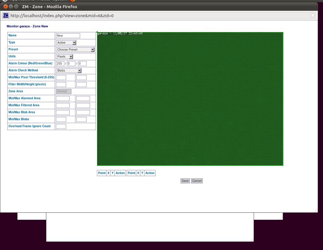

Hello zoneminder community,
after two days of extended troubleshooting the capture car I am up and running with ZM :D
The bottom line is: I can't configure any zones :(
I can't click on the preview image on the right to draw a zone like in the tutorial "How to setup motion detection" in the wiki.
I've googled for this issue all over the forum and wiki but to no avail so decided to post here.
system:
Ubuntu 11.04
Zoneminder 1.24.2
1 camera
1 TV card 878A based
I've made two screen shoots and attached them to the post, if you need and other info let me know and I will post it.
Image preview is blank because it was dark outside when I took the it.
Please help.
Thank you!

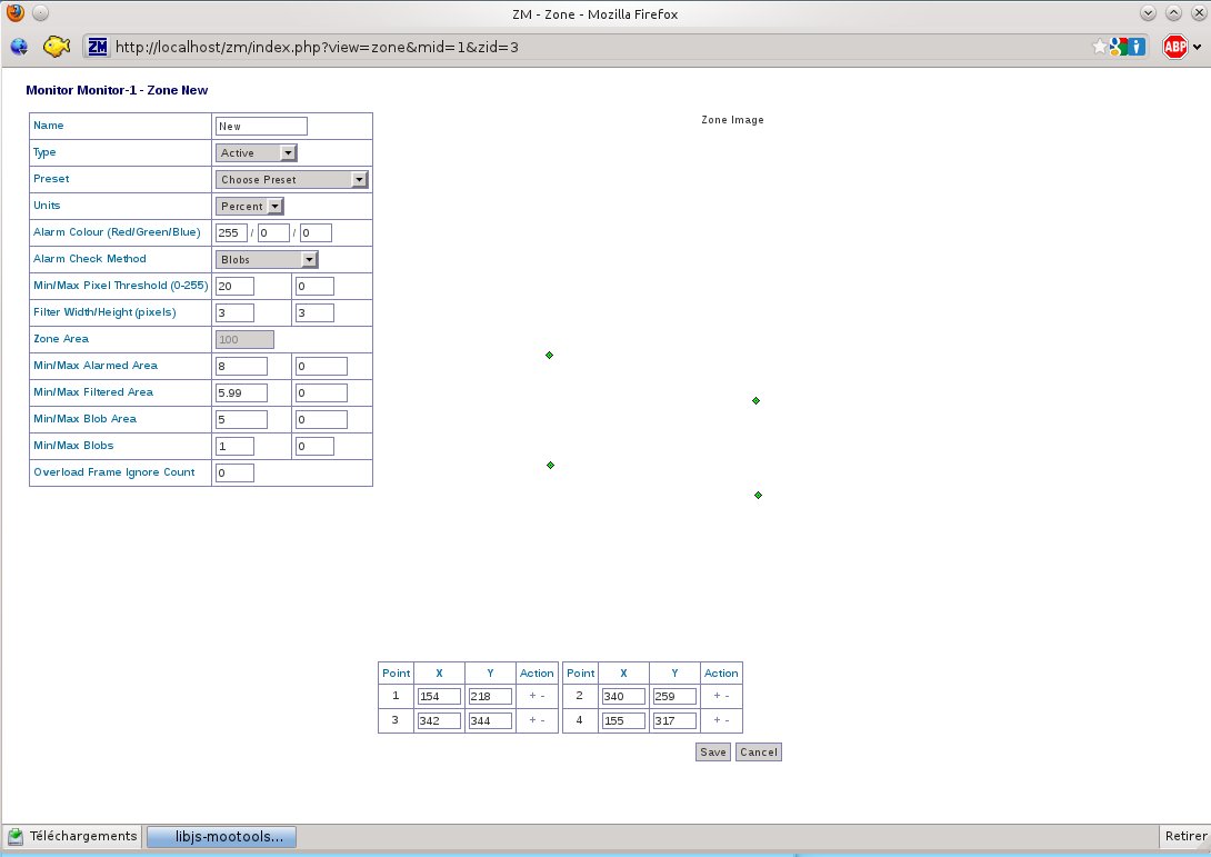

I have my too a little problem and the solution above doesn't work.
The picture in Attachments for explain : I have no image en zones selection
Zoneminder : v1.24.2
mootools : 1.31
The camera work perfectly, there is just in zone section that i can see picture.
is someone have an idea ??
No image
No image

Re: Problem configuring motion detection areas - zones
Post by cordel »
Check your apache error log after bringing up the zone config window and it will give you a clue more specifically as to what is wrong.
I'd guess that either you have the images folder improperly configured in options, or a permissions problem with that folder.

Elringer
Joined: Thu Jun 02, 2011 9:01 pm
Post by Elringer »
Thanks for your reply,
And you have right :
sudo chmod -R 777 /var/www/zm/images
and
sudo chmod -R 777 /var/www/zm/events
solve my problem.
