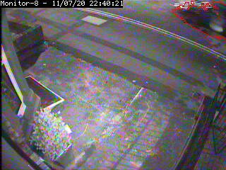

I seem to have an interlace issue as shown on the picture below. After reading some of the comments I changed resolution to 320x240 PAL but the problem is still there. Have tried to play with different values for CAPTURES_PER_FRAME as suggested in one of the posts but still no success.
I am using 8 channel BT878a DVR card with a 1/3inch Colour Super HAD camera.
Help.
Another question is it possible not to have the red line on the moving object?

You don't say what version you are using, but if it's 1.24.4 or later look at Options->Config->V4L2_CAPTURE_FIELDS and Options->Config->CREATE_ANALYSIS_IMAGES.
