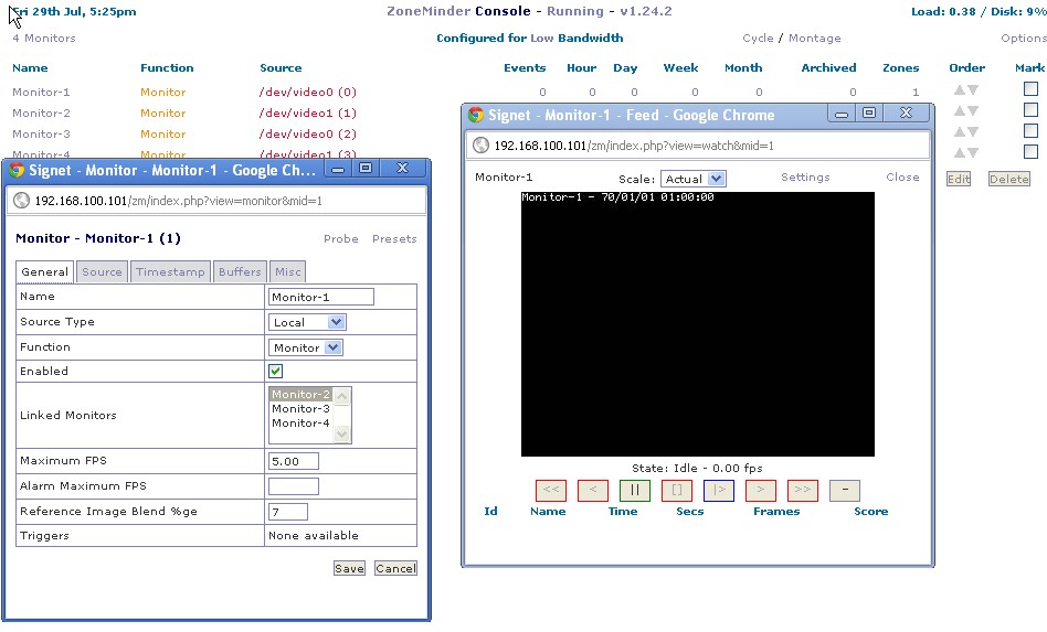

I've restarted system and now occasionaly I have a picture from cam available under web interface.
If i add limitation to 5fps max, it refreshes (very slow - each 10-15sec). The view is also, randomly correct or "black" with "dummy" time presentation.
See below
I'm not sure how to make te view smooth and stable.

Re: ZM, no camera view
Disable all monitors (uncheck enable on general tab) except for one, your choice. Hook the camera up to the correct connector for that device. Compare your source tab settings against the ones in the source tab (.png) above; the general tab you posted doesn't help when you don't have a feed at all. If you're still not getting a feed, post your source tab settings or better yet post a snap shot of your source settings and we'll have a look. Could be shared memory but I doubt it at 320*240, 24bit color. We're not to that stage of troubleshooting yet, so let's focus on source settings.
