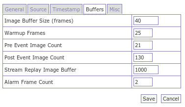

Re: Triggering question
Set alarm frame count to 5.
- alarm.png (10.04 KiB) Viewed 5862 times
