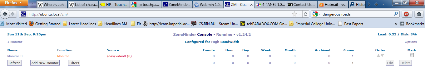

Awesome, it works now! thanks (well the camera is recognised, orange font)
But when i try to stream from it all I see is a black screen. and the words State:idle 0 fps
