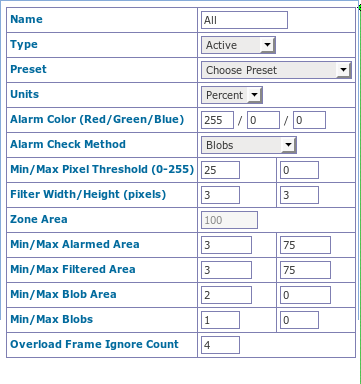

Re: Recordings doesn't stop
Leave your Reference Image Blend %ge setting at 10 and check your zone settings against these:
- Zone.png (19.86 KiB) Viewed 7359 times

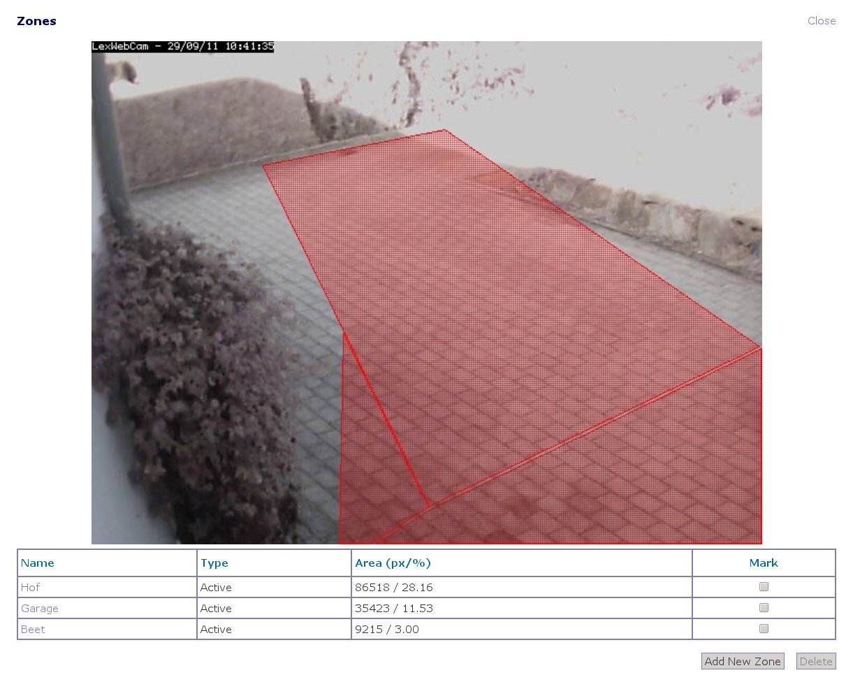

@bj99
please have a look on my three zones with your parameters.
Thanks in advance
Regrads Michael
Thanks in advance
Regrads Michael
- zones_092911_1045.jpeg (161.22 KiB) Viewed 7349 times

Hi all,
my problem isn't solved till now.
I reduced it to one zone with the settings above.
The alarm and the recording start perfectly ... but now the record of an event never stop.
Any other hints ? Thanks in advance.
Regards Michael
