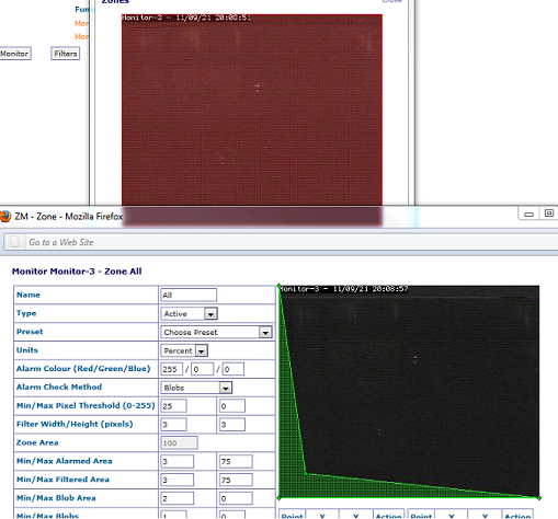

First problem is: there is no picture on monitors. But when I go to define zones it shows image from camera so monitor setup is correct (I think).

I know it's dark but picture is correct.<br />You can see the little green led from alarm at the center of image.

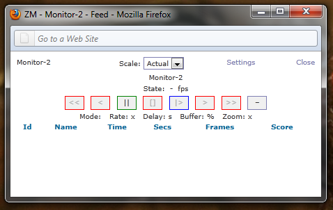

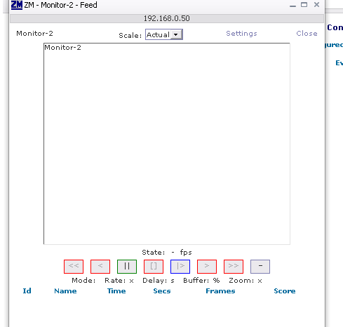

No picture.
No picture.

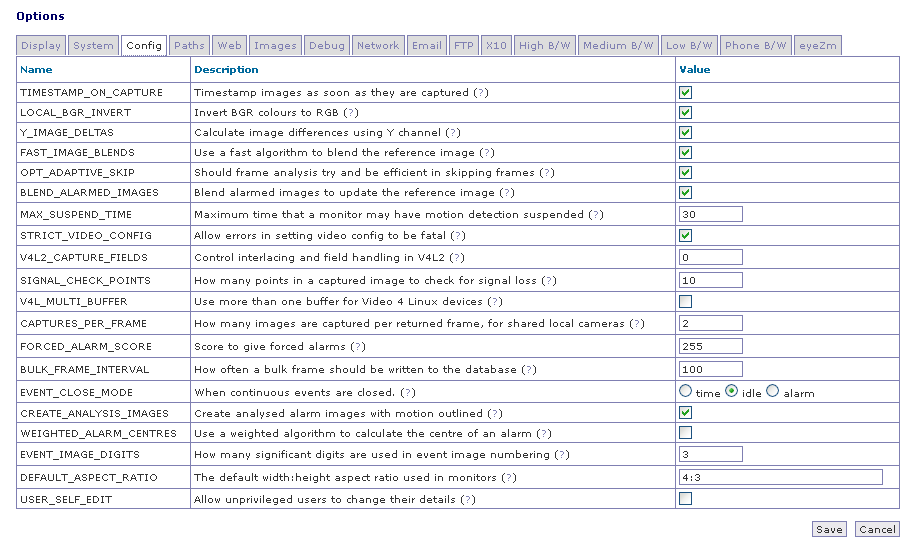

I am attaching Options window and a another screenshot of zones during the day.
Also I have found that when I open monitor in Opera it shows picture frame where stream is supposed to be but not the stream - attached that too.

Opera screenshot
Opera screenshot
My current options
My current options
Zones
Zones
