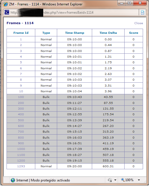

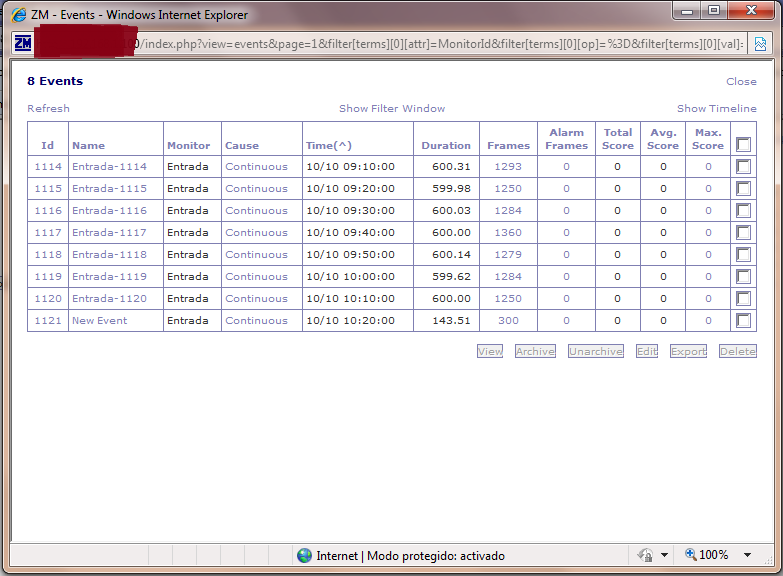

I'm getting lots of alarms on my one zone, causing recording of thousands of frames. However, for each event the alarm frames = 0, total score = 0, avg score = 0. On the monitor page I see the events each with score 0/00.
What is causing this? Shouldn't I see a score > 0? When I look at still I don't see any red areas, and the timeline graph is stuck at 0.
What is wrong? I have a camera with a bit of noise (RF interferance) so there are occasional lines running across the screen but shouldn't those cause scores or red areas?

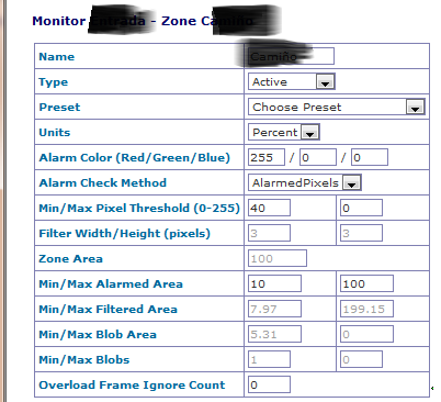

- Zone.png (22.44 KiB) Viewed 6710 times
- Frames.png (80.6 KiB) Viewed 6710 times
- Events.png (80.66 KiB) Viewed 6710 times

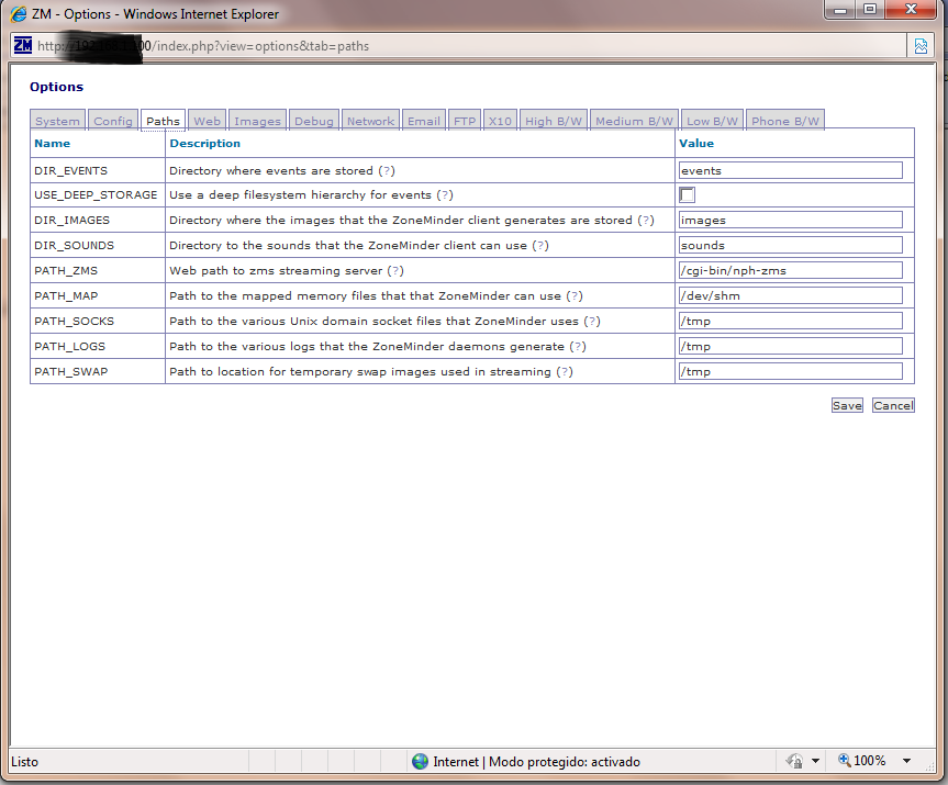

Re: Lots of alarms, but always 0/0 score
Incorrect event/images location?

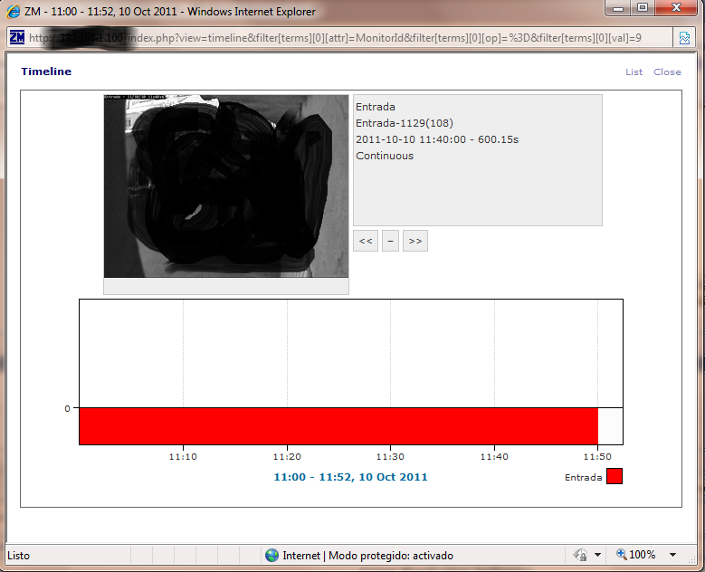

I don't think:
Events and images are stored correctly (I think), If you check the timeline, moving the cursor around the time zone (the red wide line), you can see how the images change (just like a film).
The problem is that most of times, there is no real alarm; there is nothing wich triggers that alarm.
- Paths.png (83.19 KiB) Viewed 6708 times
- TimeLine.png (126.32 KiB) Viewed 6708 times

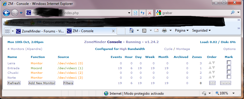

Hola,
In which mode have you setup your camera (mocord, modect, etc)?. It looks like you have a continuous recording more, so no alarms are going to be trigger with motion, you will have only a fixed set of frames/time being recorded.
PacoLM
PS: Si quieres mas ayuda, mi email es mi nick at gmail.com. Saludos. Paco
PacoLM
No one of the cameras is in "Record" mode; three are in "Monitor" mode and the other one is in "Mocord" mode, but is wich records continuous.
- Console.png (113.56 KiB) Viewed 6701 times
