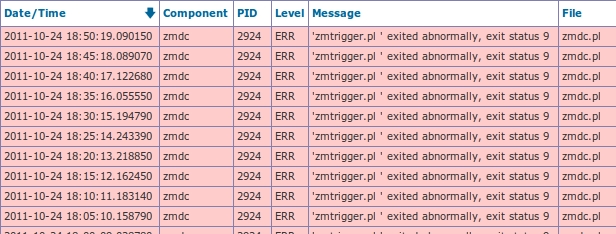

10/24/11 update: Checked OPT_TRIGGERS in the options. (previously, as in the wiki, just added it to the zm start script) With OPT_TRIGGERS, zm will restart zmtrigger.pl when it crashes. Before it would just die. Helped some, particularly when I lowered the MAX_RESTART_DELAY.
It's still crashing though. Oddly, exactly every 5 minutes, 1 seconds. Like a clock...

- crash every 5 min, 1 second.
- zmtrigger2.jpg (121.14 KiB) Viewed 2714 times
