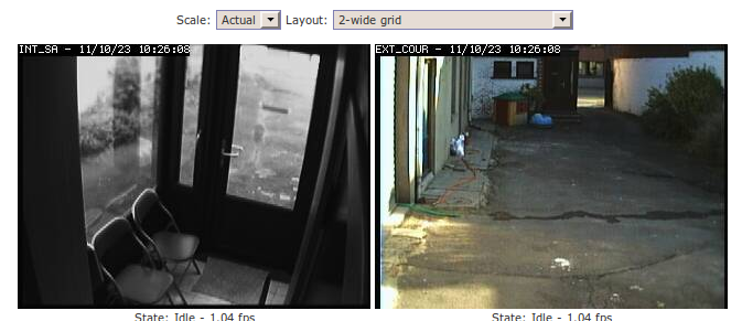

I installed a server (Linux version 2.6.32-26-generic Ubuntu)with TW6805 card and 4 cameras.
Everything is working fine except that color cameras are not displaying the real color of things.
I'm running 320x240 in RGB24
In the attached picture the :
yellow box is blue in reality
the light blue part of the children's house should be yellow in reality
the roof of the children's house is green on screen but also in reality
the door of the children's house is dark blue and should be red
Any idea what is causing this stange effect ?

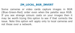

Try using the BGR24 palette or toggle the options::config::LOCAL_BGR_INVERT
From ZM help:

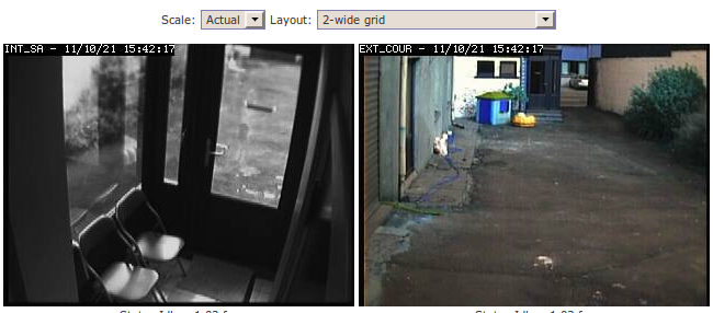

thanks for the tip , I knew it was someting like inverted signals but I did'nt saw the INVERT fuction.
Now it's perfect
