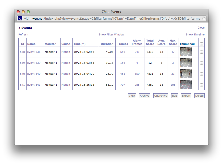

So, I adjusted those settings to what you suggested and it seems to work a TON better.
Weird thing is my admins go up, and walk through, and zoneminder made three seperate videos. Seems each zone they went into, it made a new event.
But then I went up and had a single event for the whole thing. Which is what I want to do.....

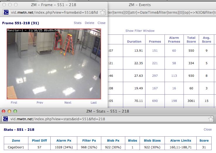

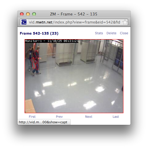

I just realized with your progress that I've done you a disservice. You can bring up an event and clink on stills; if you have options::config::CREATE_ANALYSIS_IMAGES ticked you can look at exactly what ZM saw as motion and what it did not based on the red border (based on your posted zone settings; r=255). This tip is a great help in fine tuning zone sensitivity and eliminating false alarms.

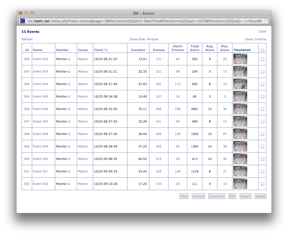

So this is what I came into today. 12 Events, based off the same 'visit' in the room.
You say increase your post buffer? What exactly is that? The Post Frames? At this point, I happen to be the only one working on the project as the other guy is back to asterix for now.

ive got the analysis stuff working and sometimes it wont actually give that data. Its kinda strange but so far its working fine.bb99 wrote:I just realized with your progress that I've done you a disservice. You can bring up an event and clink on stills; if you have options::config::CREATE_ANALYSIS_IMAGES ticked you can look at exactly what ZM saw as motion and what it did not based on the red border (based on your posted zone settings; r=255). This tip is a great help in fine tuning zone sensitivity and eliminating false alarms.
