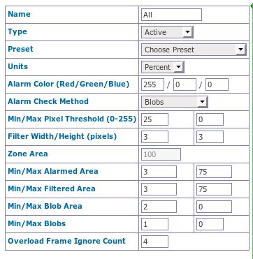

allangood: Please post your zone settings and monitor function they should be something similar to: Modect and -

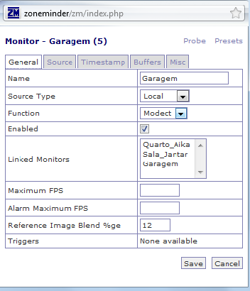

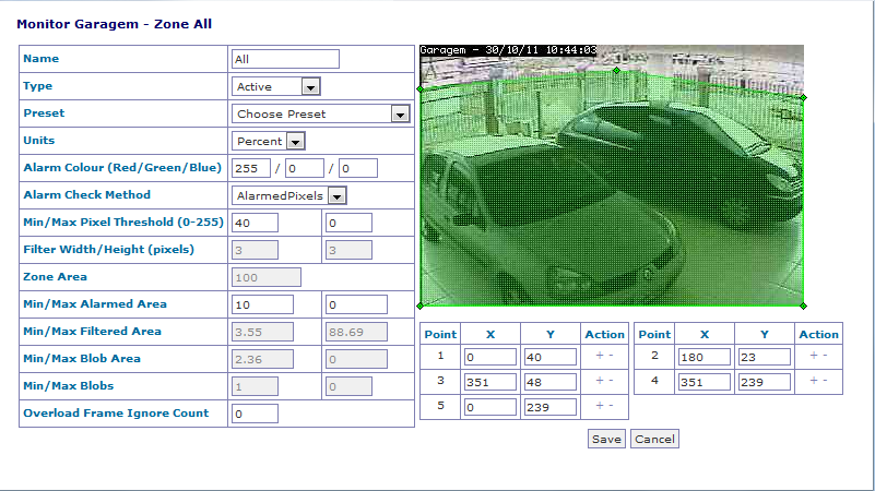

Re: No modetect
Hi masterknife,
here my configuration, and sorry for the late of my reply.
I believe theres no error on my config, becouse I has another instalation with the same configuration, but a cheap bttv chip card.
I think this is a issue with the mjpeg palette...
So, any help will be very appreciated!
Many thanks.

Re: No modetect
Hi allangood!
My zone settings look not too different from yours for my car parking.
Your zone settings are good, with one exception: you told the AlarmedPixels motion detection step to only trigger an alarm when a minimum of 10% of the zone was changed! This is too much! Try values between 0.5% and 3% and see what works best.
mastertheknife
