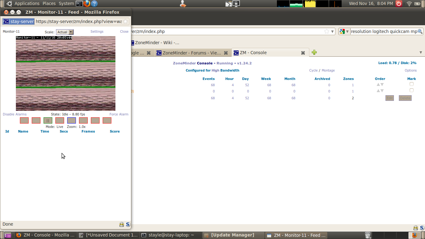

Getting a little closer. Still could you some guidance!
I change the resolution to 320x240. (Still NTSC and YUYV). I can monitor the video now, but it is "corrupted". The time stamp now updates, but no real image (see attached screenshot).

- Screenshot.png (228.75 KiB) Viewed 5202 times

Try PAL and YUYV instead of NTSC Most modern USB cameras require V4L2 to be in PAL mode.

Just to mention that I have the same issue.
I use a logitech HD c270, which refuses to even stream anything. Probably another issue, but it does not work clearly.
My other cam does 'work' in much the same way as the picture above. It's a logitech c300. Tried any config as user above, to no avail. Even tried to set capture width/height to 80/60.
I'm on ubuntu 10.04 LTS and zm 1.24.
Ideas more then welcome...
