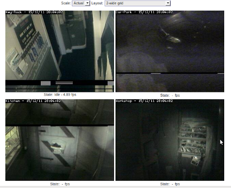

I'm not convinced it's a drive problem, I've put files on my website to show the problem

The cameras are more than 5 years old and are made by Swann with a CE number N3960
General:
Name Key Rack
Source Type Local
Function Modect
Enabled Yes
Linked Monitors Car Park, Kitchen, Workshop
Maximum FPS 5.00
Alarm Maximum FPS 5.00
Reference Image Blend %ge 7
Triggers none available
Source:
Device Path /dev/video0
Capture Method Video for Linux 2
Device Channel 0 (1 is the car park, 2 is the kitchen and 3 is the workshop)
Device Format PAL
Capture Palette RGB565
Capture Width (pixels) 320
Capture Height (pixels) 240
Preserve Aspect Ratio blank
Orientation normal
Buffers:
Image Buffer Size (frames) 40
Warmup Frames 25
Pre Event Image Count 10
Post Event Image Count 10
Stream Replay Image Buffer 1000
Alarm Frame Count 3
Misc:
Event Prefix Event-
Section length 600
Frame Skip 0
FPS Report Interval 1000
Default View Events
Default Rate Real
Default Scale Actual
Signal Check Colour #0100BE
Web Colour Red
There is attached a screen shot of the montage.

Ah, you have a capture card in there. Did that involve the installation of drivers, or does ZM support it without drivers?
It makes sense living where you live to use PAL, but is there any chance the cams are NTSC? It just that it seems something is not syncing up..
What happens if you delete the value '5' from the Maximum FPS and Alarm Maximum FPS? If I set those values, I am unable to capture are the rate my cams are capable of capturing, and ZM has issues. I just leave them blank.

Re: No more pictures
The card has been running for about eight years now, 3 of them in Linux.
The card is a BT878 which again has been running fine and I do believe that they were set to PAL originally.
It was worth a shot removing the FPS's, but no change. Is there anywhere else in the options table where there is a FPS that could be set?
If I play around with the pixel settings, things go haywire quite quick, e.g. changing to 300 x 240 and only the first picture is good, the rest are all over the place.
Maybe the settings have to be exactly right, but if so, what would be the settings for a single BT878 chip controlling 4 cameras?
4 cameras on one chip = all settings must match exactly! Make sure that the options::config::V4L_MULTI_BUFFER is unchecked and that the options::config::CAPTURES_PER_FRAME is at a value of 2.
Fingers crossed, that seems to have done the trick bb99.
