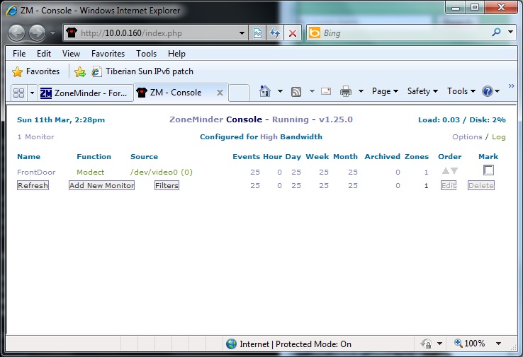

Have an odd issue video works for up to 1 hour, no errors in the logs that I can see. The source shows green, when I click on the name it looks to have a freezed frame. If I restart ZoneMinder it shows a green screen. If I reboot the server everything is good for about an hour.
DVR Card Camsecure 5008 PCIe card
ZoneMinder v1.25.0
Syslog server is clean
Events from zoneminder logs show that it is processing and capturing but it isnt really doing it.
2012-03-11 14:27:04.475712 zma_m1 4407 INF FrontDoor: 3000 - Processing at 2.00 fps zm_monitor.cpp 1055
2012-03-11 14:27:03.450069 zmc_dvideo0 4405 INF FrontDoor: 3000 - Capturing at 2.00 fps zm_monitor.cpp 2598
2012-03-11 14:26:52.104163 zms 4640 INF Got signal 15 (Terminated), exiting zm_signal.cpp 44
2012-03-11 14:18:44.468181 zma_m1 4407 INF FrontDoor: 2000 - Processing at 2.00 fps zm_monitor.cpp 1055
2012-03-11 14:18:43.450051 zmc_dvideo0 4405 INF FrontDoor: 2000 - Capturing at 2.00 fps zm_monitor.cpp 2598
2012-03-11 14:17:41.579925 zms 4624 INF Got signal 15 (Terminated), exiting zm_signal.cpp 44
2012-03-11 14:13:29.064564 zms 4605 INF Got signal 15 (Terminated), exiting zm_signal.cpp 44
2012-03-11 14:10:24.456980 zma_m1 4407 INF FrontDoor: 1000 - Processing at 2.00 fps zm_monitor.cpp 1055
2012-03-11 14:10:23.450064 zmc_dvideo0 4405 INF FrontDoor: 1000 - Capturing at 2.00 fps zm_monitor.cpp 2598
Video stops working, more like freeze frame after 1hour
- ZoneMinder Feed (Green)
- zoneminder_feed.jpg (70.51 KiB) Viewed 4015 times
- Zoneminder Console
- zoneminder_console.jpg (88.98 KiB) Viewed 4015 times
