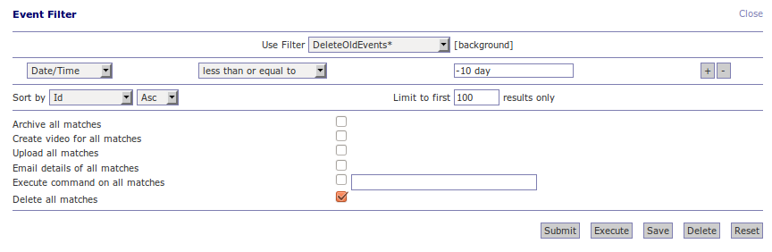

This is a filter that I have to delete events older than 10 days.
Hope it helps,
PacoLM

Ok, here is my question, I don't have the Delete option in my filters. I have one that says Purge When Full. So how do I get the Delete Option in the filters?

desills wrote:Ok, here is my question, I don't have the Delete option in my filters. I have one that says Purge When Full. So how do I get the Delete Option in the filters?
Have you seen the image attached some post above yours?. The delete option it's a checkbox at the end of the window, not a filter...

Ah, ok, I do see the Image a few post above mine and yet I do see at the very top of that image in the Filter Select Box that the user has selected next to where it says Use Filter, a filter entitled DeleteOldEvents*. I do not have that filter option available. I do have the Delete checkbox at the bottom, but it really looks to me like this guy IS using a filter and the Delete Checkbox at the bottom allows him to delete items matching the filter he has selected at the top. Please educate me if I am wrong.

I know this is old but since I'm here I'll answer this question properly. I know that probably (more like FOR SURE) the guy fixed his problem. I'm actually trying to help those that in the future find this post somehow.
The screenshot taken is a already saved filter so that's why you're seeing the name on the list. Actually, you're on this page to actually CREATE this profile that you're not finding. So, put in the option CHOOSE FILTER and that will give you the chance to add a new profile. In the name, you'll choose a description that you want for the filter - any name that you want. In the screenshot he used that name that you're not finding on the list - "DeleteOldEvents".
The rest you can copy what he did. Afterwards you click on SAVE at the bottom.

Hi
In the latest zoneminder, don't have Date/Time. It has Start Date/Time and End Date/Time
Which one should be selected.

Start Date/Time works fine for me.
