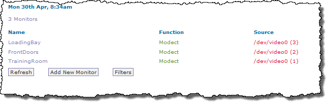

Good morning and thank you for the replies.
After talking further with a friend, he has also suggested this may be a resolution issue as opposed to anything else.
The "LoadingBay" camera is "GT-DBI2070 NTSC and PAL compatible". The settings for LoadingBay monitor are defined in Zoneminder thusly:

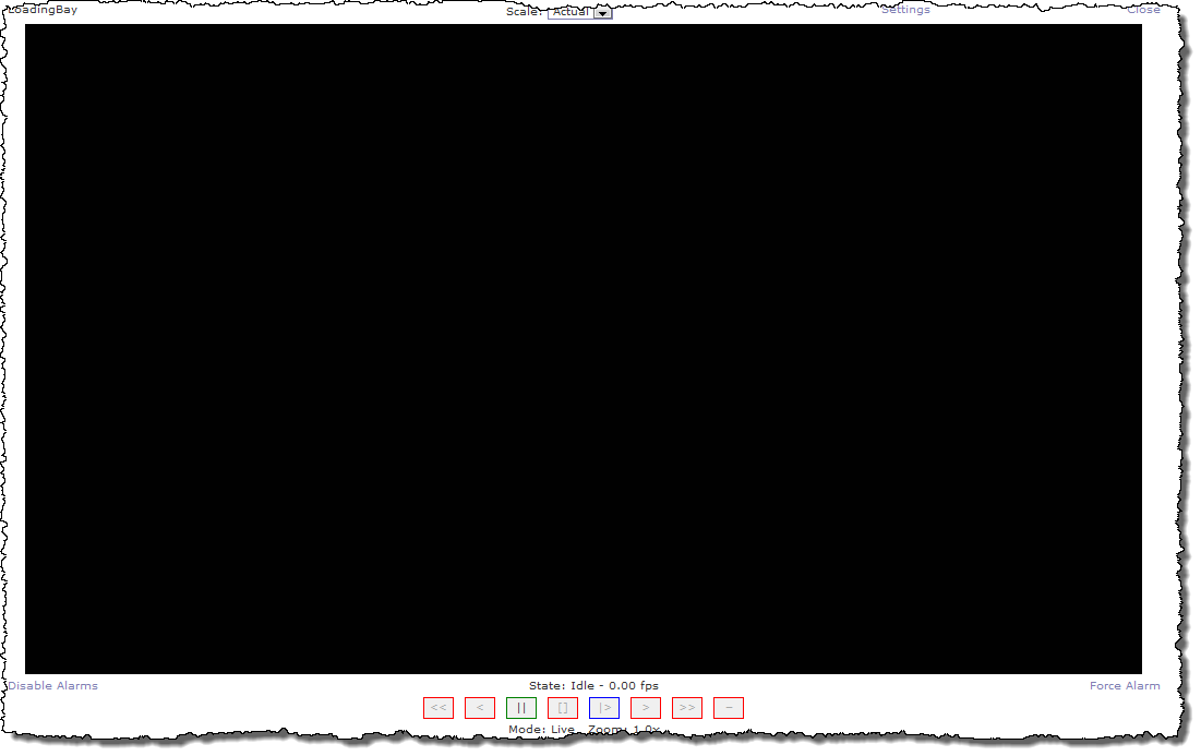

The user manual for the camera states: Effective picture is NTSC 1028 H x 508 V (Horizontal and Vertical) or PAL: 1024 x 596 (it makes no mention of palette or which V4L to use, the instructions for the BT card however say to use V4L1 but no matter what setting or configuration I use, I don't get a picture at all).
If I set the resolution to this camera in ZM accordingly, I get a black output (see attached screenshot) and all the defined monitors go 'red' and no longer display anything!
Additional info : I searched for the black-screen on BTTV cards and saw a link back to the forum (http://www.zoneminder.com/forums/viewtopic.php?t=10108); for info, my "uname -a" is Linux 2.6.18-308.4.1.el5 #1 SMP Tue Apr 17 17:08:10 EDT 2012 i686 i686 i386 GNU/Linux. Not sure if it's relevent but posted just in case!

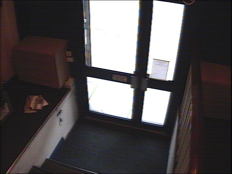

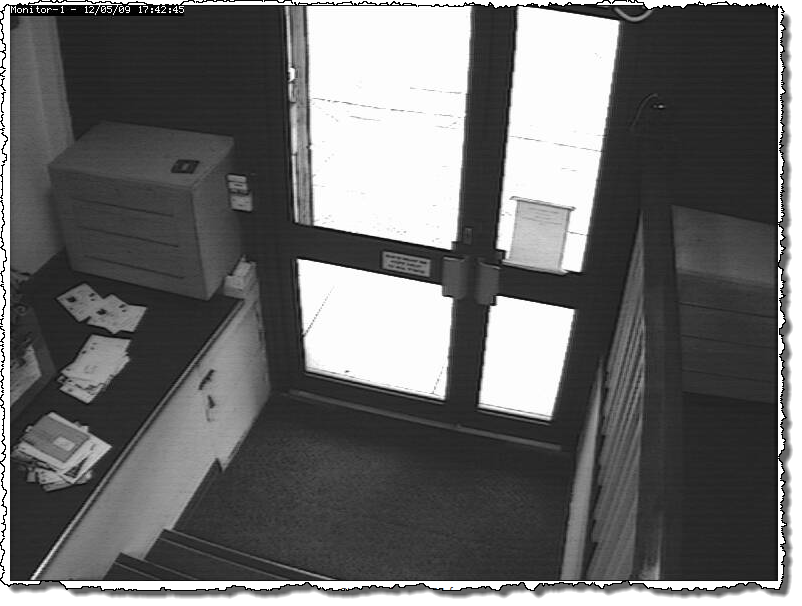

OK so after nearly a week of trying various configurations I am still having very limited success with Zoneminder and my cameras
I have removed all monitors bar one and figured that if I can get at least one working then it will be a step forward. However, I must have tried every single combination of Format and Palette but no matter what options I select I can only get a display in greyscale with using the 'PAL' format and 'GREY' palette. I've installed and run xawtv and the cameras all give me a colour display and I can run them in any resolution/size (I had it up to 1600 x 900 px at one point!) so what's the deal with Zoneminder, why is it so picky??!!
The success I have enjoyed with xawtv shows me that the card and cameras are both A-OK but I am at a loss how to get it working as well in ZM.
ANY help here would be appreciated!
EDIT:
Added some grabs, colour one is from xawtv the greyscale is from ZM
EDIT:
- ZM
- 04-05-2012 10-09-04.png (193.14 KiB) Viewed 7023 times
- XAWTV
- snap-unknown-20120504-105833-1.jpeg (37.72 KiB) Viewed 7023 times

I am sorry if I wasn't very clear in my post above so let me try to improve this:
I have two problems ...
Problem # 1
If I have a single monitor defined (/dev/video0 channel 3, Format PAL, Palette GREY at W 768 x H 576) I get a picture, it's stable and the Motion detection works etc as expected.
Should I change these settings to try to get the image in colour, I end up with nothing (see attached screengrabs). Irrespective of if I configure PAL or NTSC, as soon as I set the palette to something other than GREY, I get the empty monitor window.
I have used the following line in my modprobe config file but that makes no difference
options bttv gbuffers=16 card=133,132,133,133 chroma_agc=1
So at the moment, I have a 4 port card with a single camera in, displaying a greyscale image which is also in a lower resolution then I am sure it can handle.
Problem # 2
I have a second camera, which is actualy exactly the same make and model of camera as the one I have "working" above. If I then try to add this as another monitor with the same parameters (obviously on the correct channel) then the images on both camera jump around as can be seen in my little video --> http://viveuk.net/support/tmp/cam.html.
Problem # 1
Problem # 2
- /dev/video0 channel 3, Format PAL, Palette ANYTHING ELSE at W 768 x H 576
- 09-05-2012 16-44-19.png (12.28 KiB) Viewed 6965 times
- /dev/video0 channel 3, Format PAL, Palette GREY at W 768 x H 576
- 09-05-2012 16-43-41.png (252.37 KiB) Viewed 6965 times
