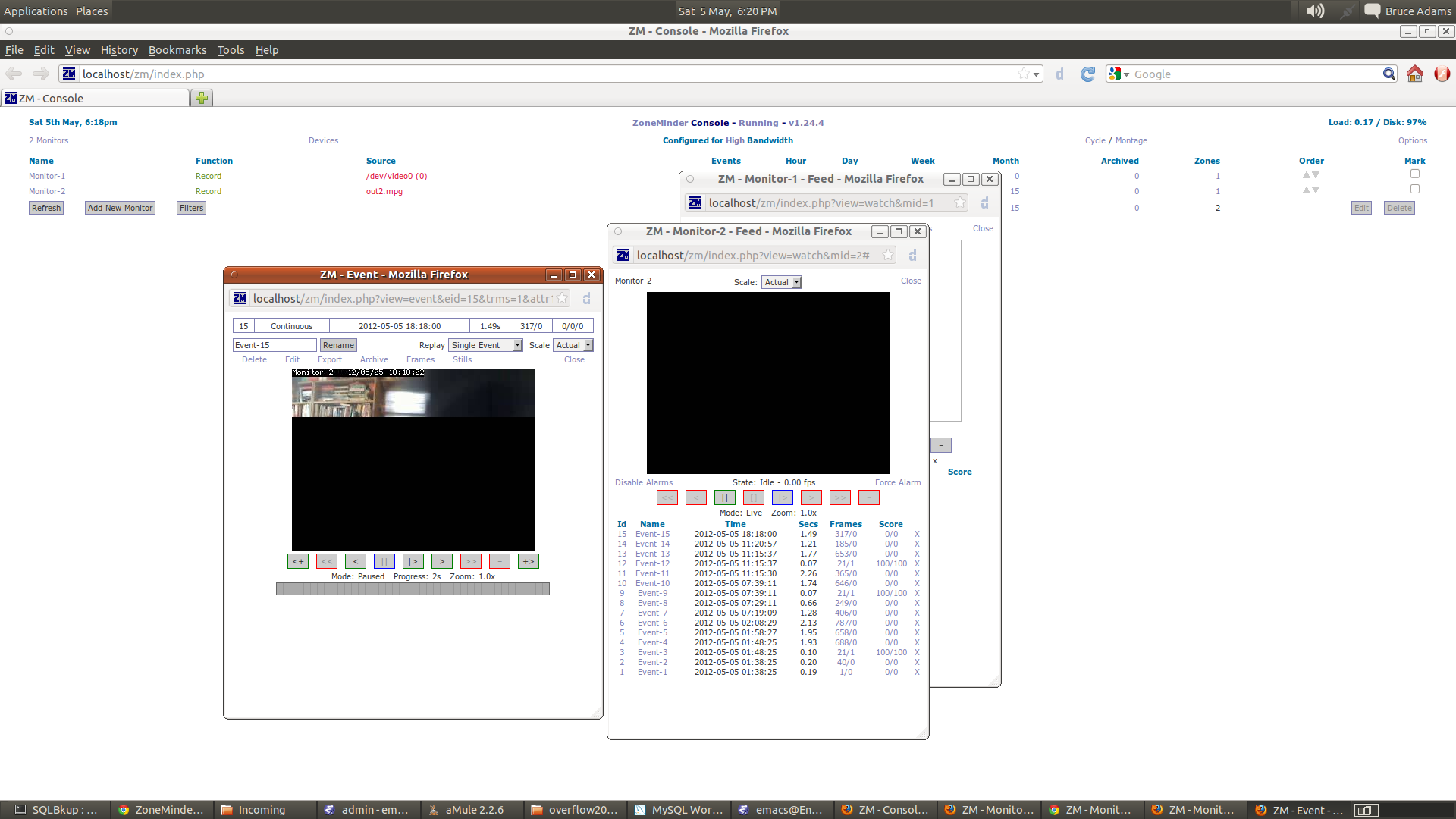

I'm also trying the ffmpeg approach. It seems to sort of work. A few events were recorded. A image blipped up a couple of times then disappeared.
On playing back the event I see a brief clip then half a picture (see attached screenshot).
I tried what you suggested just in case but no joy.
- zoneminder2.png (191.56 KiB) Viewed 4442 times
