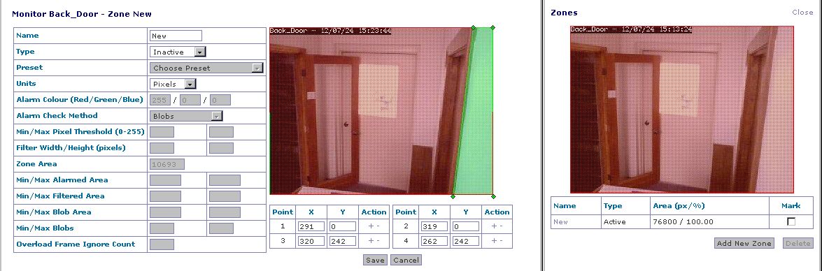

I have an issue that is happening when ever i add/change zones for the running monitors. I have screen shots so I'll explain with the names of which one I'm using.

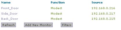

If i edit the Zone for "Back_Door" monitor and add an inactive zone to the far right side (against the wall.. nothing is ever there) after I've added the new zone, saved it (i did change the zone name afterward, did it after the screen cap there are 2 zones at this point) and go back to the main screen, under Source it has changed from Green to Orange, sometimes it goes red. Once i delete all the zones and add a "FULL (100%) ZONE" i go back to the main screen and source is green again.

I'm at the moment only testing on the Back_Door monitor, once i can get everything up and running on this one, i'll jump to the other two and make the correct zones for that. Is there anything i can do to fix the change to orange? Does it really matter that it has changed from Green to Orange after making the change to the Zone?

- Edited Main Page after adding the 2nd Zone
- Source_Orange.jpg (13.54 KiB) Viewed 4772 times
- Adding the 2nd Zone.. renamed it to inactive after screen-cap,
- Source_Green.jpg (13.91 KiB) Viewed 4772 times
- Added the Inactive Zone, Plus original Unedited Zone to the left
- InactiveZone.jpg (122.5 KiB) Viewed 4772 times

I figured out what the issue was and why it kept popping up orange after adding the 2nd Zone.
The Camera size is 320x240. If your X/Y go beyond the "Size" of your camera, you start to get errors in the log.. Move it off by 1 pixel and it should be fine. I changed mine to 239 instead of 240, and 319 instead of 320.. Everything went back to green and the zones work correctly now. I've added multiple zones and no more issues.
I hope this helps anyone else that may run into this issue.
