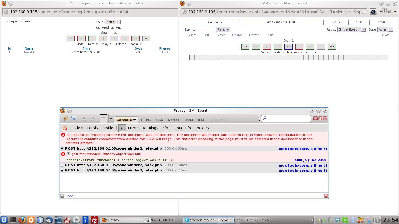

Hey everyone, im having some problems with my ZoneMinder 1.24.4 installation.
I can get a local source and a remove source(mjpeg_streamer) running and in the logs i can see that it is processing the images. However in the http interface i only see 1 event, when trying to view it i get nothing. I tested both MPEG and JPEG output. When using firebug it says "StreamingImg is Null" which I guess is a javascript error.
The stream works fine in both sources when viewed from another software so I dont think its the webcam itself. For the record, its a logitech cs230(uses the same board as cs250 so i use the zoneminder settings for that one).
Been at this all day now so have anyone any idea of what this might be that causing this? /var/log/messages and /var/log/syslog says nothing about warnings or errors even though i have debug level at 9.
I have attached an image that shows the 3 windows. My best guess is that the error "streamingImg is null" is exactly what it sounds like, that its not getting the stream, but i dont understand why it isn't since its clearly showing in the logs that its receiving jpeg data.
Any help is appreciated!
