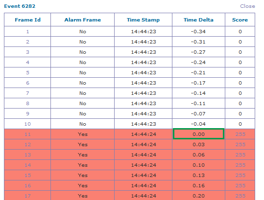

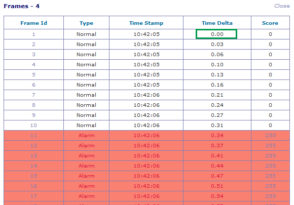

I have been using an older release (1.22.3) and just recently that box crashed. So, I installed the newer 1.25 version.
With the newer version, I noticed that the Frames, Time Deltas now start at the 1st Pre-Event frame rather than the 1st Frame of the Alarm Event, like the older version did (1.22.3).
Specifically, I am triggering the start of the "event" using zmtrigger.pl.
Any idea why this changed and/or if there's a configuration to get this to work properly (like in 1.22.3)?
See attachments for the two comparisons in the time delta reporting.
Thanks for any help and/or information regarding this,
J.J.
ZM 1.25 Frames incorrectly showing the start of the first Pre-Event as 0.00 Time Delta, rather than the first frame of the actual Alarm as Time Delta 0.00.
ZM 1.22.3 Frames correctly showing the start of the alarm (within the total event) as 0.00 Time Delta.  Pre-Event frames are negative (as expected).
