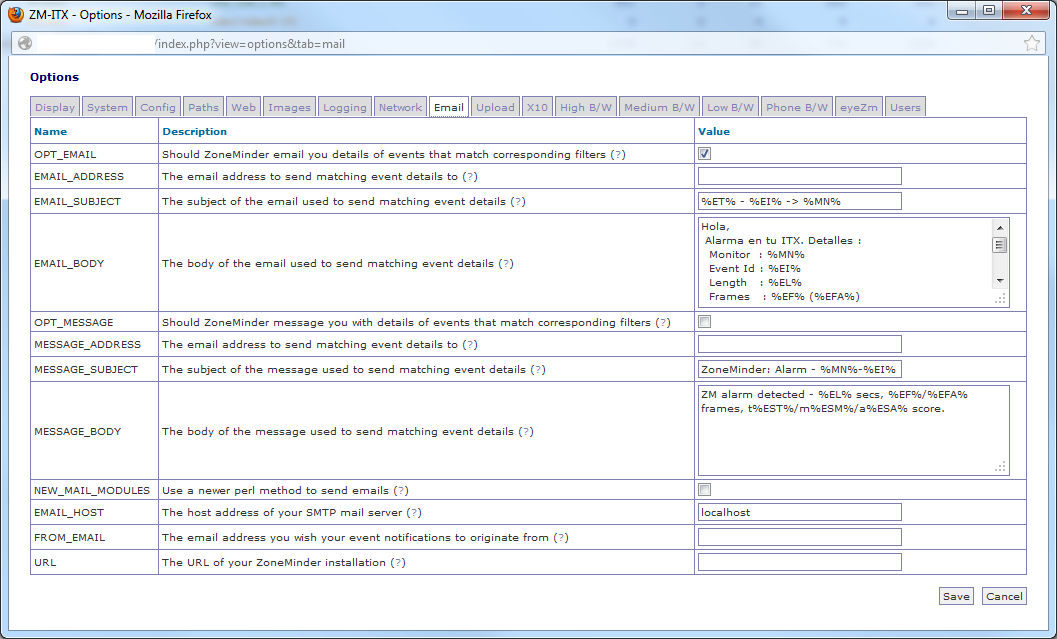

Check that after setting up postfix as internet mailer, set the parameters in the Options::Email as shown in the picture ZMmail.png. After setting this up, you have to create a filter that will enable to send emails, as shown in the picture ZMfilter.png.
In the Options::Email tab, remember to fill up the parameters:
EMAIL_ADDRESS: the destination address for the messages
FROM_EMAIL: the mail sender address
EMAIL_HOST: mine works with localhost
Hope it helps,

Re: email setup on new install......newbie alert
I finally figured it out......seems like it was incorrect settings in the main.cf file of postfix that was keeping it from working with my email carrier (1and1)
I was able to find what the correct settings were on this site:
Do a google search for postfix 1and1 smtp, it was the second one on the list and was titled:
"Using postfix to send mail via 1and1 or other authenticated SMTP"
Sorry, new user...cant use links yet
This site shows how to setup postfix to send emails out through 1and1.
The reason I went looking for this info was because I finally found where the mail log file was and it was showing authentication errors from the smtp server.
It is located in /var/log/mail.log
Using putty, I opened a terminal window and used the following to monitor the log file to see where the problems happened:
tail -f /var/log/mail.log
Hope this helps others.
