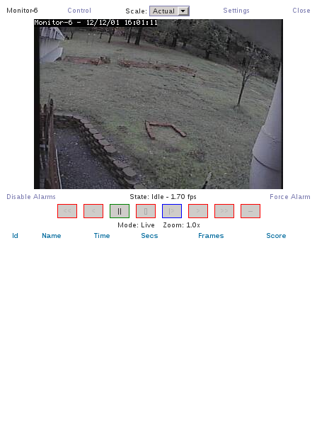

Hello All,
I have set OPT_USE_AUTH to TRUE since I want to be able to access ZM when I'm at work. I have set up an additional account and logins are now required when I browse the site.
However, since I've enabled the OPT_USE_AUTH option, I can't see the Monitors/Streams (I'm still new to this and my terminology may be off). If I turn off the OPT_USE_AUTH then I can see the Monitors again. So I suspect that I have not set up user permissions properly.
I'm attaching the config screen for my admin user. I'm hoping someone can point out which setting is wrong and is preventing me from seeing the Monitors with OPT_USE_AUTH turned on.
My goal is to allow my remote login to be able to select the "montage" and see the Monitors but not be able to make any other changes.
(A secondary goal is to limit Admin login to localhost).
Any help you can give would be appreciated.
Thanks!
This is what I see with AUTH turned off.
This is what I see when AUTH is turned on

The problem is that the auth info is not passed correctly to zms as you can see if browsing the logs.
Can fix this by setting AUTH_RELAY to none.
