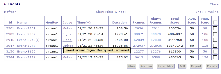

Bug with camera links that causes long events & incorrect st
Mmmh, I have a more worrisome problem.
My only 720p camera (aircam dome via RSTP), is the one generating a lot of fake events, and some are very long (like 3 hours), which sucks a lot of disk when there was no motion.
I see cause:
Signal (linked: aircam1Motion: allSignal: Reacquired)
Signal (linked: aircam1Signal: ReacquiredRecovered)
Linked (aircam1Motion: All)
This clearly looks like a bug to me. Any idea how to work around it?
I see cause:
