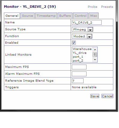

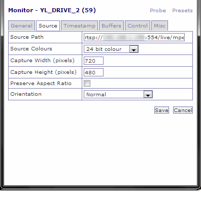

Thank you for your information... I've been trying again with your settings, and 4fps but I think I must be missing something. I still get a blank screen saying it's waiting for localhost.
Have a look at the Monitor screen by adding XujJ to imm.io
I've also added screenshots of the ZM Config at these imm.io locations...
Console: Xukx
General: XukR
Source: Xulu
Timestamp: XulQ
Buffer: Xume
Misc: XumL
If I use the same connection string in VLC on the same desktop, I get this: Xun3

- Posts: 17
- Joined: Fri Feb 22, 2013 1:27 pm
Re: AVTech IP Camera config
It seems I can add attachments though
- Screen cap
- 016-capture.jpg (50.2 KiB) Viewed 8802 times
- Untitled-1.png (9.03 KiB) Viewed 8802 times
- Untitled.png (9.4 KiB) Viewed 8802 times
