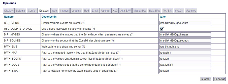

aodiaz wrote: 2013-08-20 20:12:01.055164 zms[4767].ERR-zm_event.cpp/1225 [Can't open /usr/share/zoneminder//media/hd160gb/events/3/13/08/20/19/53/05/001-capture.jpg: No such file or directory]
Looks like you tried to redirect your events folder over to your 160gb drive. However, that drive is outside of your webroot, which means zoneminder can't access it. Steps to fix:
1) set your events folder under Options -> Paths -> DIR_EVENTS back to the default "events"
2) now either link your 160gb disk to the events folder like this:
sudo rmdir /usr/share/zoneminder/events
sudo ln -s /media/hd160gb/events /usr/share/zoneminder/events
*** OR ***
Mount your 160gb disk directly to the events folder by adding an entry to your fstab like this:
/dev/sda3               /usr/share/zoneminder/events ext4 defaults,noatime,nodiratime,commit=120,data=writeback      0 2
You will need to change "sda3" to whatever is appropriate for your system.
In either case, make sure that www-data has appropriate file permissions to write to the disk.

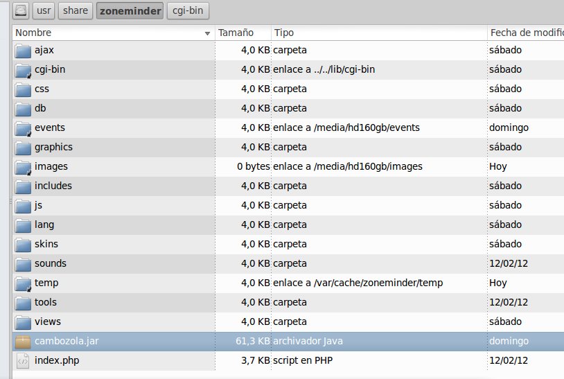

Perfect!!!, It worked!!, But now I question arises whether the following links are well configured ..!
folders links.jpg (79.04 KiB) Viewed 4575 times
particularly wanted to know if the link to the cgi-bin and temp folders are correct ...!?
Regards! ¡¡¡¡¡¡genius!!!
Antonio
Re: Cambozola problem in the reproduction of events
If you have not previously changed them yourself then yes they are most likely correct.
