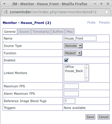

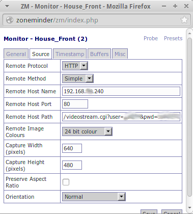

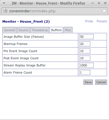

As for the camera configs, I've attached some screen shots showing some of the changes to get it working better:
If anyone has any suggestions for getting the system tweaked a little more so I can get event monitoring and recording working better I would appreciate it. If you need additional info, just let me know and I'll try to get what you need.

As a start change Pre Event Image Count to 2 seconds worth of frames. Change the Post Event Image Count to 10 seconds worth of frames.
To help any further we'll need to see your zone settings. Good luck

bb99 wrote:As a start change Pre Event Image Count to 2 seconds worth of frames. Change the Post Event Image Count to 10 seconds worth of frames.
Thanks bb99. As I'm getting about 12 fps, so I adjusted the pre event to 24 and the post even to 120. I'm now seeing events that are longer and it seems to have captured more of the event, like when the car pulls into the drive way, I now see who it is that gets out of the car and comes to the door. I'll let these run for a while and see what, if any, other tweaks I can do.
