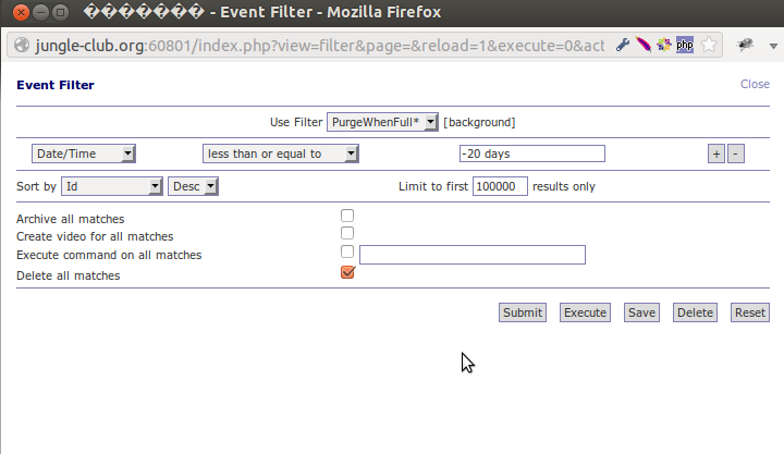

I have a some problem when filter is run. I have a filter for delete old events "- 20 days".
When it start my process load is too high and i can connect to my zoneminder server.
How i can configure my filter for optimal cleaning of old events?

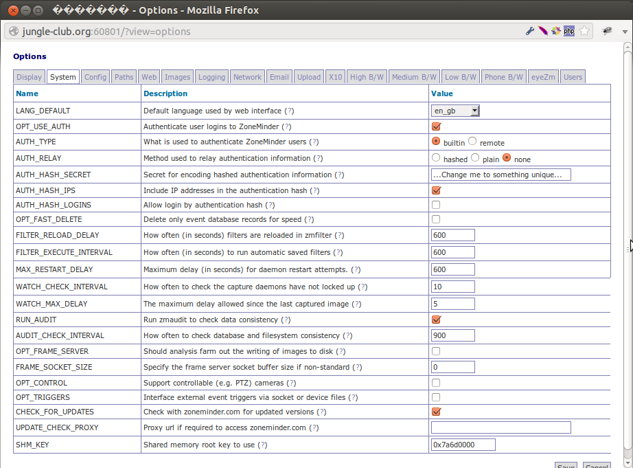

My config in screenshots.

- system.png (111.23 KiB) Viewed 1655 times
- filter.png (34.77 KiB) Viewed 1655 times

Consider the "limit to first X matches" option, it looks like it's trying to delete a LOT at once. This will make things run slowwwwly until it completes, in my experience.
Try setting to "limit to first 100 matches" and run it more often (e.g. every 5 mins) and see if it will slowly eat down the "old" events to a manageable level.
Only you can say how many events is "normal", a camera pointing at an empty passageway: 0 events per day. 1 for the cat maybe.
Camera pointing at a main road doing ANPR duty, thousands per day.
If it feels too many, have a look at the events, are you recording far too much non-movement from leaves blowing, shadows moving?
