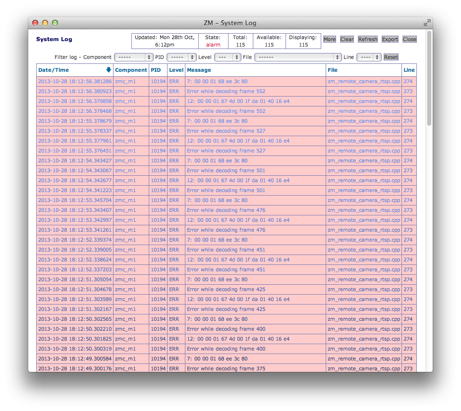

Hello, last days I try Zoneminder 1.26.4, Ubuntu Server 12.04 and Dlink DCS-6113 cam.
Installed by this guide
http://www.zoneminder.com/wiki/index.ph ... e_easy_way
I can connect my cam using rtsp. Http does not work - don't know why.
If I connect cam using rtsp I can see a lot of error - like this. But picture looks good.
Screen Shot 2013-10-28 at 18.12.56.png (226.56 KiB) Viewed 12939 times
If I connect cam using ffmpeg, and provide path to cam rtsp://IP_ADDRESS:554/live2.sdp
I have not any errors - but image quality not good.
Also I try older version of ZM - it does not work at all with my cam.
chippy99 - sas: temporary solution to this is to copy the 1.26.3 version of zm_rtp_source.cpp from the src directory into the 1.26.4 release and recompile with that.
But I can not find old version of Zoneminder. Also unfortunetelly, I have not enough skill to couple ZM from sources.
