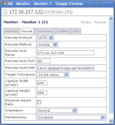

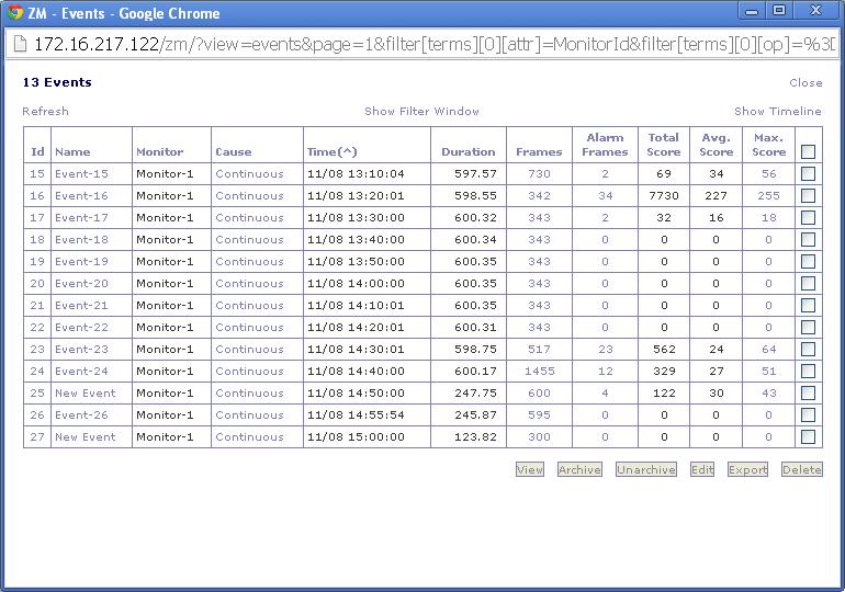

Mi first and only monitor setup in Mocord mode, produce continuous events thus it records from camera constantly
Every 600 seconds (the "section length" i suppose) a new event is generated
Of course the problem is there are no movements where camera is pointing.......
Camera is an Axis 2100
Any suggestion ??
Any suggestion ??
