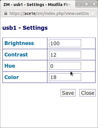

bbunge>>I have a simular problem, but totally diff hardware.
zm>>126.5 from ppa
ubuntu 12.04 server (no x11)
old acer netbook, atom chip, cracked screen therefore all access ssh or apache.
My install finished successfully, linked apache, permissions, delay zmfix 15, etc.
I installed 2 remote ip cams and they are working fully. Modect, logging alarms etc, filters working, view feed in zm, external browser works. Still have to setup email and a few things.
Problem::: when I tried usb cam (at the acer) zm does not display feed!!! zmc is working capturing the cam, but display is black. The console colors are orange or green corresponding to monitor or modect. Forced alarm triggers sound and event but no video.
tail /var/log/syslog gives >>
zmc_dvideo0[24493]: INF [usb1: 22000 - Capturing at 6.25 fps]
I know this doesn't help you, but if some one knowledgeable sees this maybe it will help. At least to give us a clue what to check next.
EDIT>>Monday morn...its working for me. The color settings were severely outa whack, so night lighing produced black??? >camera name>settings>
