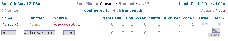

i was using v1.27 on an Arm board.
the status in Console is always 'Stopped', the Name list showed Black without poplink and the Source list showed red.
all the log messages seem right. and I can record videos using ffmpeg.
when i ran '/usr/bin/zmdc.pl check' in console, it got 'running';
and when i ran '/usr/bin/zmdc.pl status' in console, it got the following:

but, i added some debug print in /var/www/html/includes/functions.php, i found:
in function daemonCheck(), '/usr/bin/zmdc.pl check' got 'stopped';
why can this happened ? what is the difference between running perl script on console and calling by the php script ?

Did you ever figure this out? I am having the exact same problem.
Systemctl starts zoneminder with no problems, all the daemons are running, but when I open the console in a browser the status is "stopped". I can't click the links to view live streams, but events get recorded and the counters are updated on the page.
I'm on Fedora 20 and v1.27
proxenus
Joined: Mon Apr 07, 2014 2:13 pm
Re: Source shows red and running status confusion
Post by proxenus »
I got it! I found that when I started the console with "systemctl start zoneminder.service" the file zmdc.sock was created in /tmp/zm/
THEN I saw that when I started zoneminder from the console zmdc.sock was created in /tmp/systemd-httpd.service-XWAEDkq/tmp/zm/
I had to modify /usr/lib/systemd/system/httpd.service and change PrivateTmp=true to false. This is not advised due to security risks, but in my case it was acceptable.
