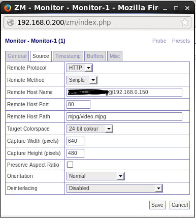

What is the configuration of the camera in zoneminder?

IC-3115W config
IC-3115W config
Pretty much everything not on this page is still at the default value. I've tried messing with the buffers and resolution and stuff, but it didn't seem to change anything.

mpco
Posts: 6
Joined: Thu Sep 06, 2012 5:25 pm
Re: socket_sendto (socketname) failed: No such file or direc
Post by mpco »
That does indeed look like the problem. That post gave me the idea to try the snapshot.jpg url instead of the mjpg stream, which works well enough for what I want to do. Hopefully if anyone else that's having the socket problem runs across this, they can be aware that it might be the camera config. Thanks!
