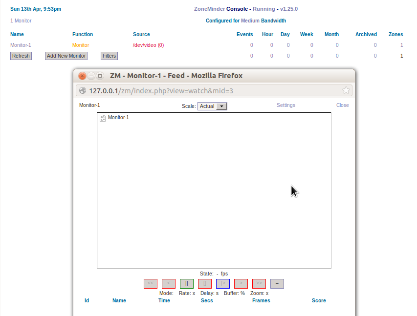

Hi all and sorry for my bad english.
Just a little problem.
Installed zoneminder, mysql and apache, under Ubuntu 12.04 lts.
from the web I open normally the zm web interface, but my local webcam is not detected.
these are the webcam data:
this is zm interface:
This is the webcam interface:
The webcam is not running under zoneminder, bu it normallly runs under cheese, skype, Video4Linux Contro Panel and guvcwiew.
how can I solve my problem please.
Thanks in advance.

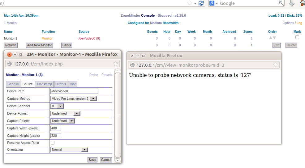

edit:
this is the zm-log:
thanks :mrgreen:

Your logfile (last post) says "Failed to stat /dev/video:" ... can you check that you have used /dev/video0 everywhere you should in the config?
It looks like you might have an errant /dev/video that does not exist, whereas /dev/video0 does.

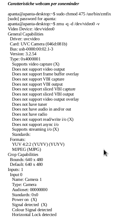

my camero is the following:
probe camera.png (81.99 KiB) Viewed 4545 times
How can I edit and check my config file?.
please give me istrucyions step by step.

You need to provide a video format and a valid palette. Try with PAL and UYYYV, I will post the correct config later.
Apanta
Posts: 6
Joined: Sun Apr 13, 2014 8:14 pm
Re: Logitech C310 webcam on zoneminder 1.25.x-ubuntu 12.04
Post by Apanta »
PacoLM wrote:You need to provide a video format and a valid palette. Try with PAL and UYYYV, I will post the correct config later.
Ok, adjusted video format on PAL and palette on UYYV and now the camera runs.
