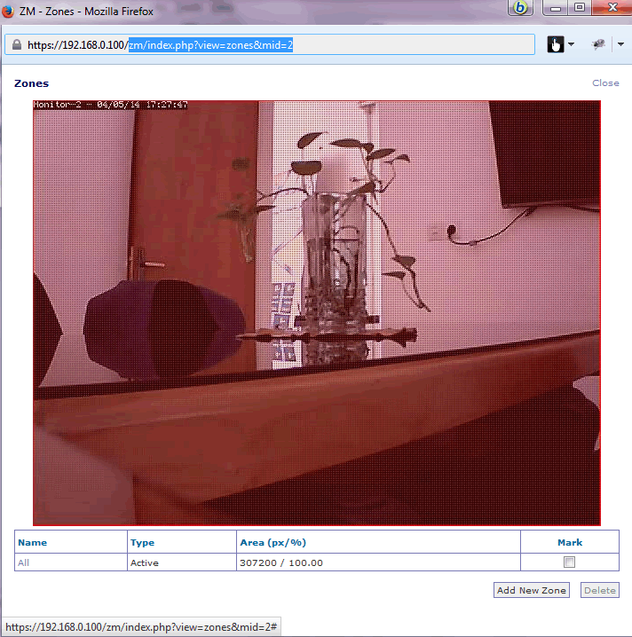

Re: TL-SC3171G Unable to get response
MY camera is SC3171G not SC3171 .
At this time i get a freezed picture on zm/index.php?view=zones&mid=2 address and attached a print screen. There is not streaming movie! its a Picture and with new refresh in my browser i get new one.
Any solution?
Screen shot is attached

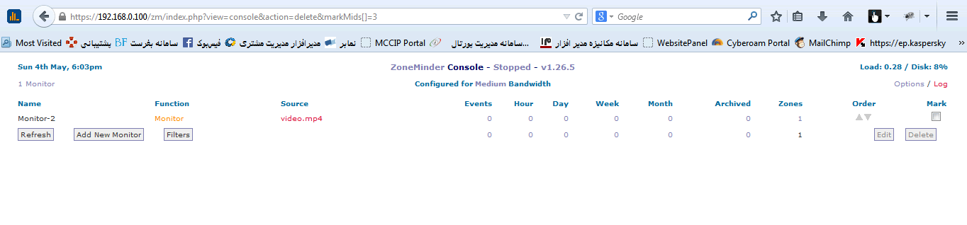

In addition in main page of Zoneminder "Monitor-2" Don't show as hyperlink. I don't know why.
