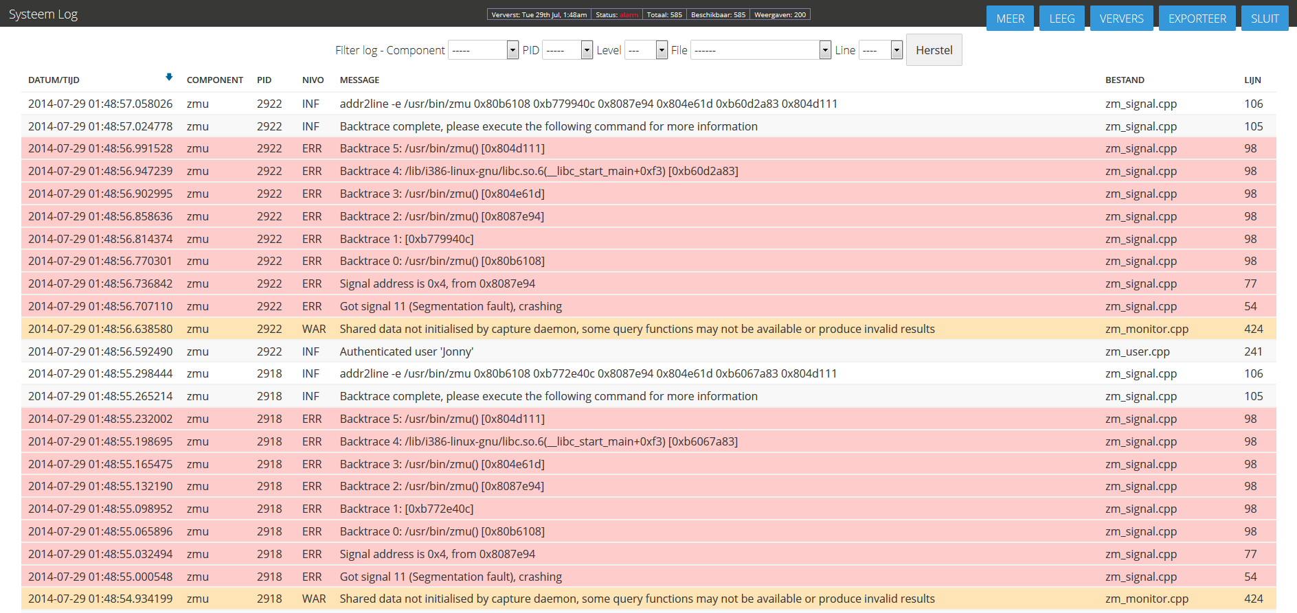

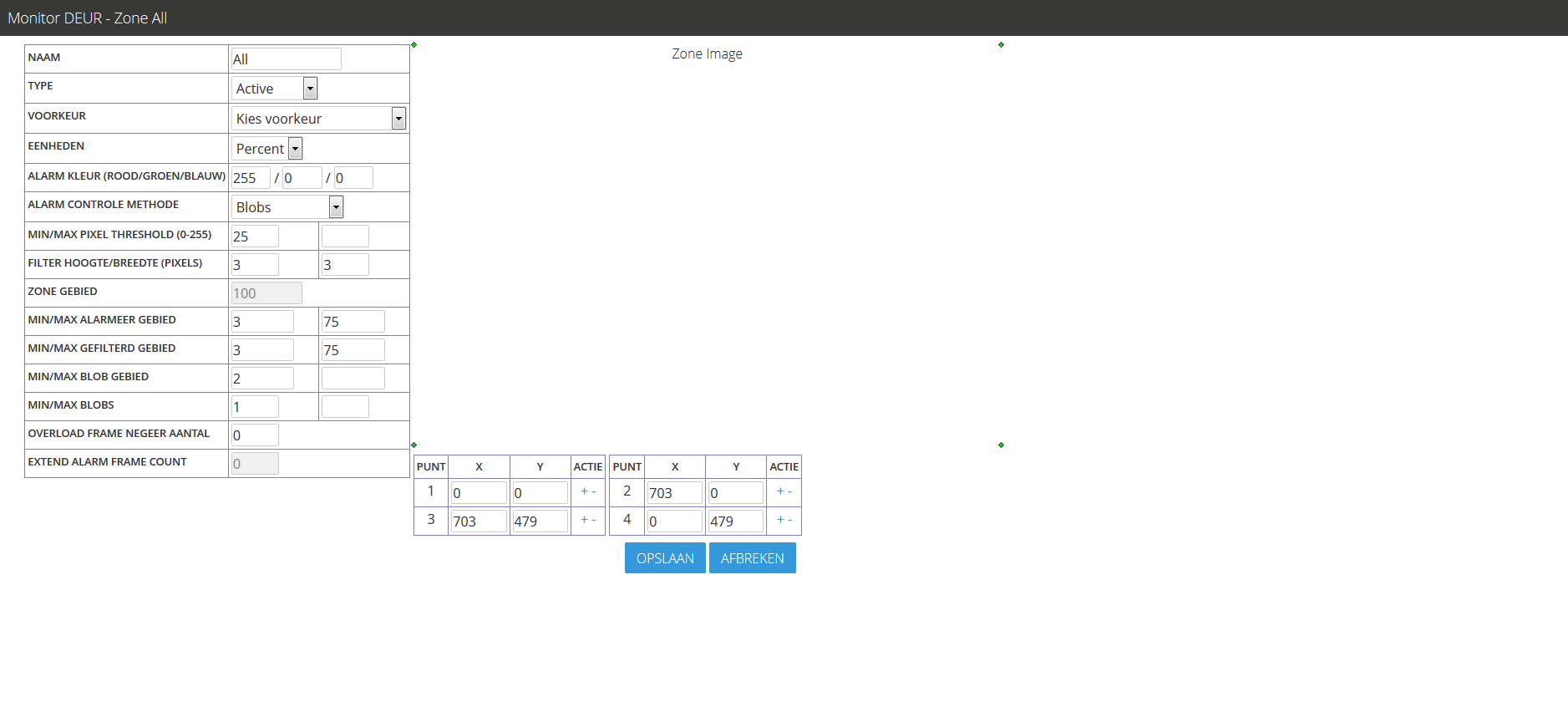

- No zones editor images i blank
- problems i my zoneminder logs
- the rest zoneminder work properly

There is a bug in the last daily snapshot from the iconnor repository. Luckily my zones are already set up and I do not need to edit to them. If anybody uses the 0726 daily snapshot from the iconnor repository they will have the same problem. There also appears to be a bug with the new multibuffering options as well though that is not as critical as the non-working zone images. One thing about using master is that we are basically beta testers. lol.

graphicw wrote:There is a bug in the last daily snapshot from the iconnor repository. Luckily my zones are already set up and I do not need to edit to them. If anybody uses the 0726 daily snapshot from the iconnor repository they will have the same problem. There also appears to be a bug with the new multibuffering options as well though that is not as critical as the non-working zone images. One thing about using master is that we are basically beta testers. lol.
Thanks for the info. than i no need more troubleshooting.

The latest snapshot is now show 1.27.99 and has addressed the zone image issues. It also appears as though the V4L issues with the addition of Multibuffering options per monitor has also been addressed though I have to test further to be 100% sure. One thing is for sure though, the new snapshot is working better than the previous.

All functions seem to be working for me as well. I am not using any RTSP or IP cameras though. My setup consists of an older Intel SE7501BR2 server with hardware RAID with 8 port BT878 cards and 10 monitors at 640x480 in greyscale. It actually functions very well considering the age of the machine. The only issue I see with the current snapshot is the following log message that will show in the log when I view a monitor:
Shared data not initialised by capture daemon, some query functions may not be available or produce invalid results
The monitor is actually viewable and functions as it should so I am not sure why this error message shows up in the log.
