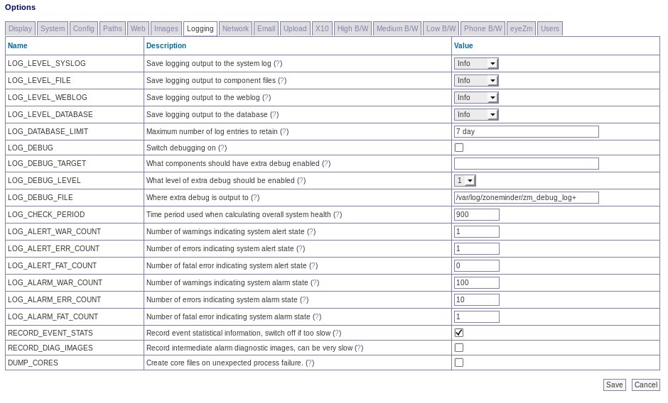

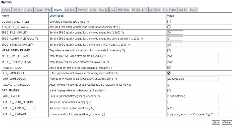

Back to your first screenshot...
You *cannot* tell zoneminder to record to a folder outside your webroot! This is by design (security reasons), and is not allowed for any process (not just zoneminder). You don't want your apache user to be able to access your entire filesystem.
So set DIR_EVENTS back to "events" and set DIR_IMAGES back to "images".
To save your events to a network location, mount your network share directly to /var/lib/zoneminder/events
Do the same thing for the images folder if you really want to, but there rarely is anything under that folder.

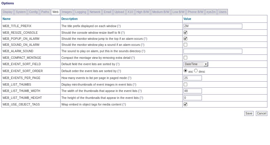

Re: Zoneminder RPM & SRPMS for Red Hat & CentOS 6
Everything else in your screenshots looks good.
If you still are having issues, I would go back to that previously known good state. Then change things to the way you want, one step at a time.
