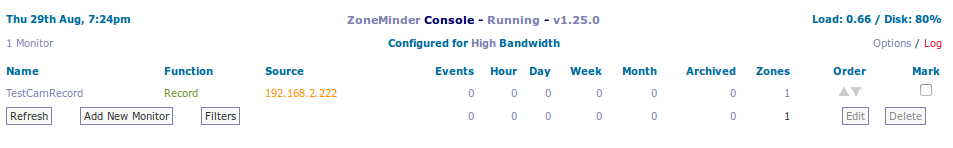

And Zm is running see attached file for screen shot of ZM running.

Your events folder looks correct for an Ubuntu machine. www-data is the correct user account that httpd runs under.
See how your source, 192.168.2.222, is orange instead of green? That's mean there is a problem with the monitor. Also notice the word "Log" is red. That's means you've got errors in your logs. Please post your log files.
