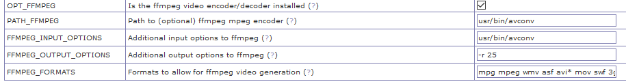

Hello! I need to jump in on this because I am having difficulties and not sure where to go. When I generate the video it fails and tells me to check the ffmpeg.log as it did for the earlier posting. The log returns
usr/bin/avonv: not found.
My first guess is it is a permissions issue but i'm not familiar enough to make the judgement.
-rwxr-xr-x 1 root root 131080 Mar 16 2015 avconv
Any help would be appreciated. ubuntu 14 / zone 1.26
- zm_options.PNG (8.84 KiB) Viewed 3461 times

Re: Video Export returned with status 12
You've got a spelling error and the path should be absolute.RyGy7 wrote:Hello! I need to jump in on this because I am having difficulties and not sure where to go. When I generate the video it fails and tells me to check the ffmpeg.log as it did for the earlier posting. The log returns
It should be /usr/bin/avconv
sorry bout that, only a typo in my post the error is correctly
sh: 1: user/bin/avconv: not found
my bad, still not working.
And this is still not right.sh: 1: user/bin/avconv: not found
Go back and look at what I said to enter. Then compare that to what you actually entered.
You need to correct both the syntax error and make the path absolute.
WOW, total duh on my part! Sorry I overlooked that and was looking at the 'c' missing. Thank you!
Making progress, got a new error, "unable to find a suitable output format for /usr/bin/avconv I'm trying some different formats as well as the Additional output options you had suggested earlier but no luck. Googling away from here.
