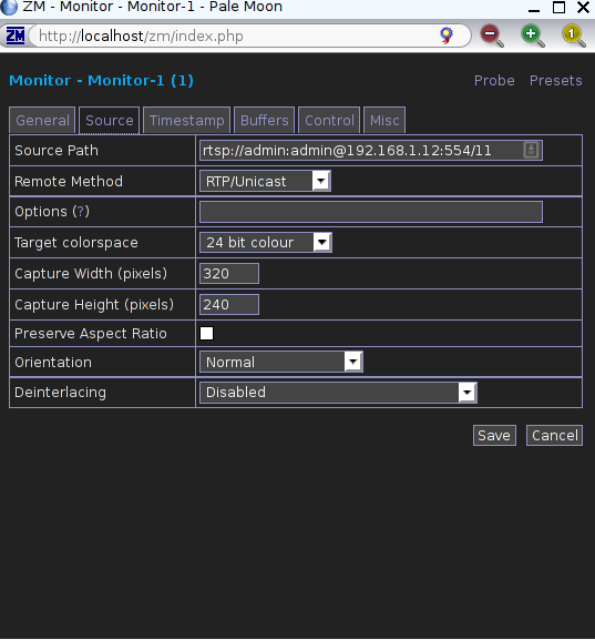

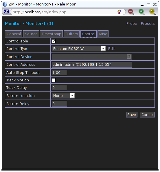

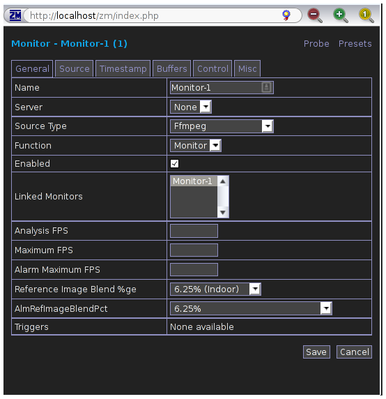

I'm back. I do see the stream with no movement again. Showing no errors in the log. Here are the pix.
I found this error in the logs after further examination:
can't access object class ZoneMinder::Control::any-control-script-here.pm
which appears just before the control server starting and no errors again until direction clicked on.
Some of the control scripts are throwing this from the sub AUTOLOAD present in some of the scripts.
