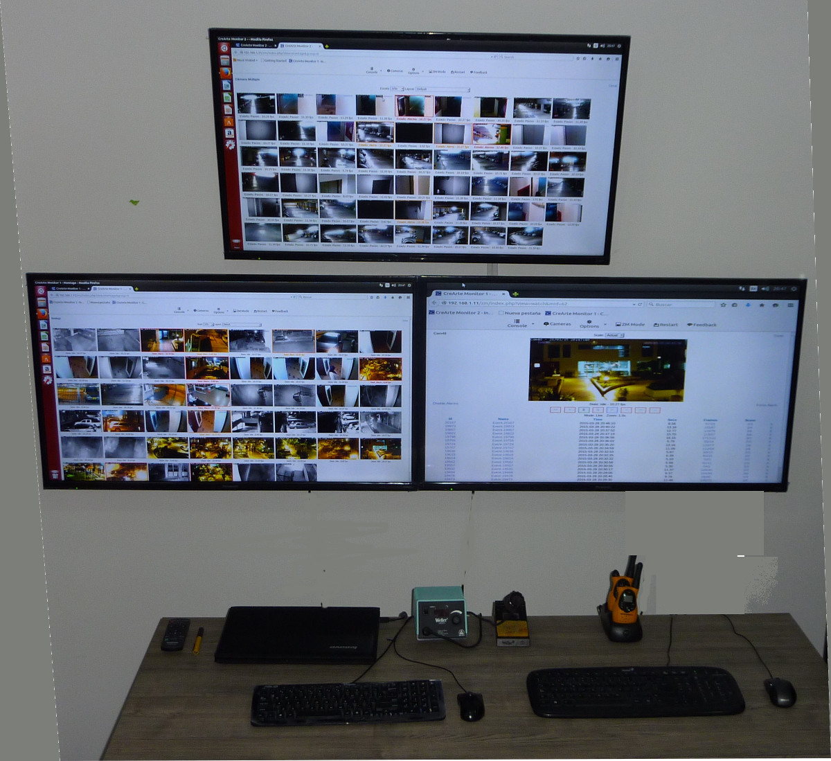

- Zoneminder huge installation
- TV.jpg (306.06 KiB) Viewed 6449 times

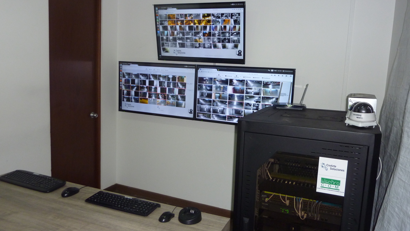

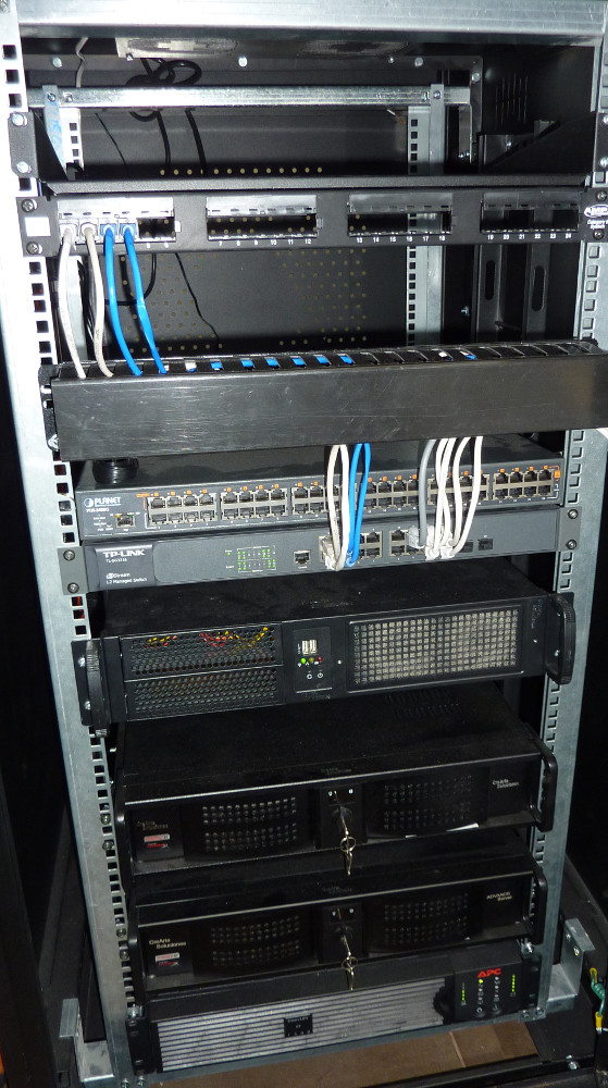

I am attaching here another view angle of the installation.
Best Regards,
Giuseppe
- rack.jpg (182.85 KiB) Viewed 6419 times
- 02 - ProyectoIMP01.JPG (749.64 KiB) Viewed 6419 times
