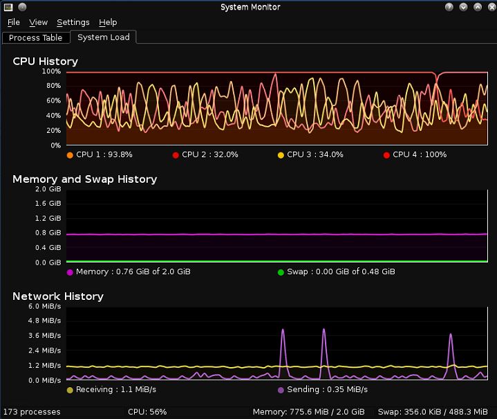

More info:
I used my ODROID U3 as a web client and was able to get all 6 cams to appear in montage. However, the pictures don't stream. They tend to refresh occasionally. I took some snapshots of the system monitor on each system.
Zoneminder system
zoneminder system
zoneminder system
ODROID web client
ordroid web client
ordroid web client
Is there a way I can improve the performance so I can watch all 6 cameras?

Re: viewing cams on RPI2 running Fedora21
You need to start telling us what your log files show, and not just a couple lines.
Again, make sure you are using Firefox. In addition to insufficient hardware resources, using an incompatible browser will cause this symptom.

2015-12-31 10:56:52.709781 zmc_m6 23296 ERR Invalid JPEG file structure: two SOI markers /builddir/build/BUILD/ZoneMinder-1.28.1/src/zm_jpeg.cpp 40
2015-12-31 10:56:52.270254 zmc_m6 23296 ERR Unable to decode jpeg /builddir/build/BUILD/ZoneMinder-1.28.1/src/zm_remote_camera_http.cpp 1186
2015-12-31 10:56:52.260411 zmc_m6 23296 ERR Invalid JPEG file structure: two SOI markers /builddir/build/BUILD/ZoneMinder-1.28.1/src/zm_jpeg.cpp 40
2015-12-31 10:56:51.578307 zmc_m1 7214 WAR Unable to capture image, retrying /builddir/build/BUILD/ZoneMinder-1.28.1/src/zm_remote_camera_http.cpp 1171
2015-12-31 10:56:51.561650 zmc_m1 7214 ERR Connection dropped by remote end /builddir/build/BUILD/ZoneMinder-1.28.1/src/zm_remote_camera_http.cpp 999
2015-12-31 10:56:51.553280 zmc_m4 8568 WAR Unable to capture image, retrying /builddir/build/BUILD/ZoneMinder-1.28.1/src/zm_remote_camera_http.cpp 1171
2015-12-31 10:56:51.542035 zmc_m1 7214 WAR Select timed out /builddir/build/BUILD/ZoneMinder-1.28.1/src/zm_remote_camera_http.cpp 157
2015-12-31 10:56:51.540538 zmc_m4 8568 ERR Connection dropped by remote end /builddir/build/BUILD/ZoneMinder-1.28.1/src/zm_remote_camera_http.cpp 999
2015-12-31 10:56:51.517341 zmc_m4 8568 WAR Select timed out /builddir/build/BUILD/ZoneMinder-1.28.1/src/zm_remote_camera_http.cpp 157
2015-12-31 10:56:51.508481 zmc_m5 7234 WAR Unable to capture image, retrying /builddir/build/BUILD/ZoneMinder-1.28.1/src/zm_remote_camera_http.cpp 1171
2015-12-31 10:56:51.496979 zmc_m5 7234 ERR Connection dropped by remote end /builddir/build/BUILD/ZoneMinder-1.28.1/src/zm_remote_camera_http.cpp 999
2015-12-31 10:56:51.487472 zmc_m5 7234 WAR Select timed out /builddir/build/BUILD/ZoneMinder-1.28.1/src/zm_remote_camera_http.cpp 157
2015-12-31 10:56:51.432668 zmc_m2 7220 WAR Unable to capture image, retrying /builddir/build/BUILD/ZoneMinder-1.28.1/src/zm_remote_camera_http.cpp 1171
2015-12-31 10:56:51.422689 zmc_m2 7220 ERR Connection dropped by remote end /builddir/build/BUILD/ZoneMinder-1.28.1/src/zm_remote_camera_http.cpp 999
2015-12-31 10:56:51.405435 zmc_m2 7220 WAR Select timed out /builddir/build/BUILD/ZoneMinder-1.28.1/src/zm_remote_camera_http.cpp 157
2015-12-31 10:56:51.400833 zmc_m7 8609 WAR Unable to capture image, retrying /builddir/build/BUILD/ZoneMinder-1.28.1/src/zm_remote_camera_http.cpp 1171
2015-12-31 10:56:51.373177 zmc_m7 8609 ERR Connection dropped by remote end /builddir/build/BUILD/ZoneMinder-1.28.1/src/zm_remote_camera_http.cpp 999
2015-12-31 10:56:51.363495 zmc_m7 8609 WAR Select timed out /builddir/build/BUILD/ZoneMinder-1.28.1/src/zm_remote_camera_http.cpp 157
2015-12-31 10:56:39.156582 zmc_m1 7214 INF bedroom: 467000 - Capturing at 12.05 fps /builddir/build/BUILD/ZoneMinder-1.28.1/src/zm_monitor.cpp 2907
2015-12-31 10:56:35.305400 zmc_m2 7220 INF PTZ: 419000 - Capturing at 7.35 fps /builddir/build/BUILD/ZoneMinder-1.28.1/src/zm_monitor.cpp 2907
2015-12-31 10:56:24.936013 zmc_m4 8568 INF SE: 385000 - Capturing at 8.00 fps /builddir/build/BUILD/ZoneMinder-1.28.1/src/zm_monitor.cpp 2907
2015-12-31 10:56:18.602528 zmc_m6 23296 INF FrontDoor: 11000 - Capturing at 19.61 fps /builddir/build/BUILD/ZoneMinder-1.28.1/src/zm_monitor.cpp 2907
2015-12-31 10:56:14.154479 zmc_m5 7234 INF GenCam: 420000 - Capturing at 7.81 fps /builddir/build/BUILD/ZoneMinder-1.28.1/src/zm_monitor.cpp 2907
2015-12-31 10:55:51.038302 zmc_m6 23296 ERR Unable to decode jpeg /builddir/build/BUILD/ZoneMinder-1.28.1/src/zm_remote_camera_http.cpp 1186
2015-12-31 10:55:51.030260 zmc_m6 23296 ERR Invalid JPEG file structure: two SOI markers /builddir/build/BUILD/ZoneMinder-1.28.1/src/zm_jpeg.cpp 40
2015-12-31 10:55:27.574072 zmc_m6 23296 INF FrontDoor: 10000 - Capturing at 19.61 fps /builddir/build/BUILD/ZoneMinder-1.28.1/src/zm_monitor.cpp 2907
2015-12-31 10:55:16.437927 zmc_m1 7214 INF bedroom: 466000 - Capturing at 11.90 fps /builddir/build/BUILD/ZoneMinder-1.28.1/src/zm_monitor.cpp 2907
2015-12-31 10:54:36.671267 zmc_m6 23296 INF FrontDoor: 9000 - Capturing at 19.61 fps /builddir/build/BUILD/ZoneMinder-1.28.1/src/zm_monitor.cpp
FatCat46
Web Console -> Top Right -> Click "Log"
Highlight, copy, then paste
Can't get any easier.
2015-12-31 11:00:38.050513 zmc_m6 23296 INF FrontDoor: 16000 - Capturing at 19.61 fps /builddir/build/BUILD/ZoneMinder-1.28.1/src/zm_monitor.cpp 2907
2015-12-31 11:00:37.119837 zmc_m7 8609 INF Shed: 349000 - Capturing at 5.38 fps /builddir/build/BUILD/ZoneMinder-1.28.1/src/zm_monitor.cpp 2907
2015-12-31 11:00:21.281895 zmc_m4 8568 INF SE: 387000 - Capturing at 8.62 fps /builddir/build/BUILD/ZoneMinder-1.28.1/src/zm_monitor.cpp 2907
2015-12-31 11:00:19.290206 zmc_m5 7234 INF GenCam: 422000 - Capturing at 8.62 fps /builddir/build/BUILD/ZoneMinder-1.28.1/src/zm_monitor.cpp 2907
2015-12-31 10:59:47.048512 zmc_m6 23296 INF FrontDoor: 15000 - Capturing at 19.61 fps /builddir/build/BUILD/ZoneMinder-1.28.1/src/zm_monitor.cpp 2907
See how none of these are even close to 30fps? That means your rasp pi can't keep up. Drop the frame on all your cameras to 5 or less.
Network error. Are you using WiFi !?!?!?
If you still get these messages after reducing the frame rate, then try a wired connection if you aren't already.
2015-12-31 10:57:50.177661 zmc_m6 23296 ERR Unable to decode jpeg /builddir/build/BUILD/ZoneMinder-1.28.1/src/zm_remote_camera_http.cpp 1186
2015-12-31 10:57:50.163450 zmc_m6 23296 ERR Invalid JPEG file structure: two SOI markers /builddir/build/BUILD/ZoneMinder-1.28.1/src/zm_jpeg.cpp 40
This means your camera is sending images that do not conform to the jpeg standard. This is not always fatal. If you are getting an image, you can ignore these. If it is fatal then change the remote Method from Simple -> Regex. See if that helps.

Thanks again for the response knnniggett
I am running everything hard wired.
I cut the FPS to 5 on all cams. and changed to Regex. It seems to help, but the live motion is not adequate to monitor in realtime. Some cams lag a minute or two behind others. I am pretty sure the PI2 is not powerful enough to run zoneminder with 6 cams. I'm wondering if an OROID with 2gb ram would be better.
Any thought?
I would hate to go through the work to find out it is no better.
FatCat46
