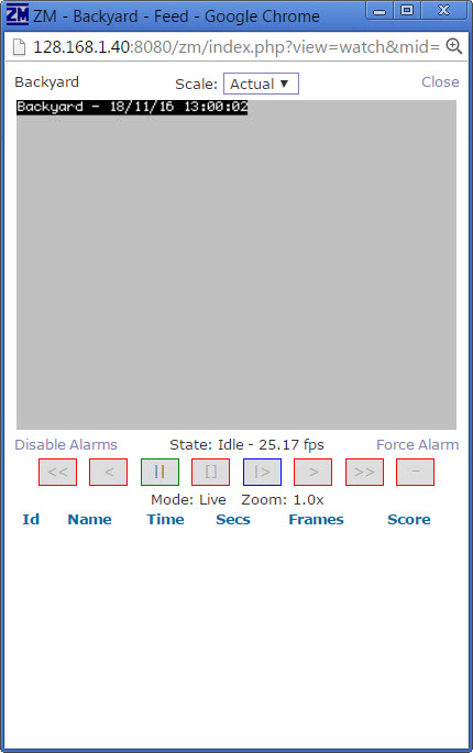

Re: Working QSee/Swann/Zmodo DVR support! - Updated 2013-04-21
How to integrate zmodopipe in zoneminder?
I have only clock shown and it's ticking.
Video grey in bw setting or red in color setting (see attachment)
Anybody experience the same?
- no_video.jpg (57.46 KiB) Viewed 14821 times

FYI, the hex dump of length 507 is your authentication message, which contains your DVR password. Please be wary of posting it!StreckerCM wrote:...
