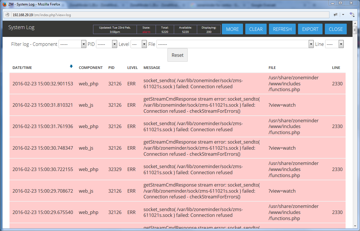

Zoneminder was installed from zmrepo, and it generally runs fine, but from time to time it stops the live streaming of all camera's, but the input streams from the cameras apparently continues, as the recognition and saving of events continues normally.
I have tried to export the log-file, but it results in just a file with zero content. Instead of this, I have attached an image of the latest log-file contents.
The only way to remedy this, is a reboot of the server. A restart of zoneminder won't do it!
Does anybody have a clue how to fix this problem.
Regards - IHR :roll:
ZM - System Log - Mozilla Firefox_2016-02-23_15-08-39.png (192.42 KiB) Viewed 8751 times

I can add a little more information to the above problem:
The mentioned socket (zms-611021s.sock) does indeed exist, and it's owned by apache:apache.
Is it normal with hundreds of socket-files in the /var/lib/zoneminder/sock directory ?
I don't thimk the problem has anything to do with the pc watching the ZM-console, as I have tried 2 different pc's with 2 different browsers.
IHR
