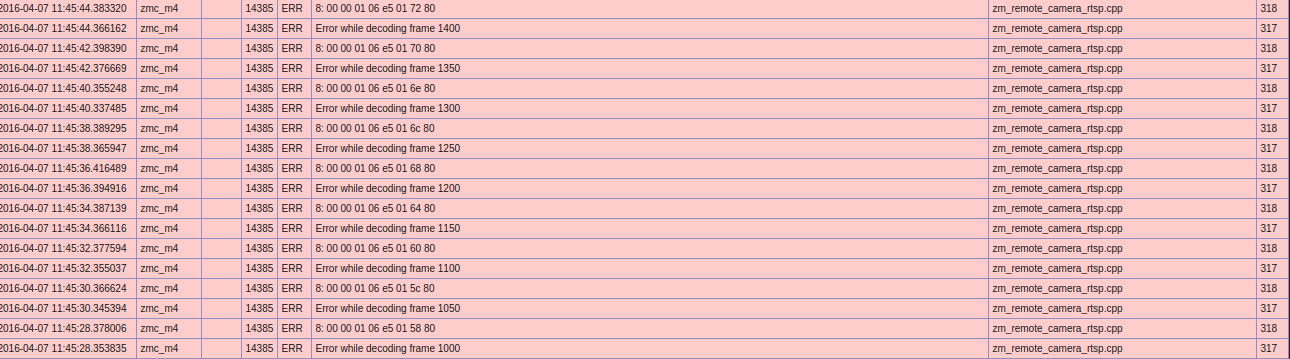

Is there anyway to have ZM not decode/evaluate Key Frames? I have a camera that I had set the Key Frames to 50 (has to be a value from 2-150). When set to 50, every 50th frame ZM sent an error:
To test I've set this from 2 to 150 as well and that is the frame I get an error on. IE if I set it to 2, every second frame ZM will return a Error while decoding frame 2,4,6,etc. If I set it to 150, ZM will return a Error while decoding frame 0, 150, 300, etc.
I have to have this setting on the camera so there's no option to disable there. I was wondering if there's a way to at the very least, stop the ERRs from hitting the log file or if there's a way to tell ZM to ignore certain errors. :shock: :?:
