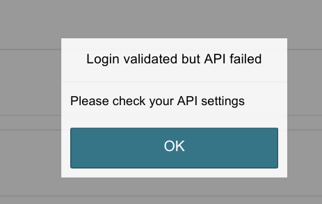

Ok, i've tried to comment the following lines in api/config/app.php:
//'Security' => [
// 'salt' => '__SALT__',
Security.salt error is vanished but when i try to connect ZM with zm-ninja i get an api error.

felixita wrote:Ok, i've tried to comment the following lines in api/config/app.php:
//'Security' => [
You can't comment those lines - add a random value instead. And I'd recommend you don't fiddle with zmNinja yet. If your APIs are not working, zmNinja won't work.
Get to a point where on your browser http://server/zm/api/monitors.json works
