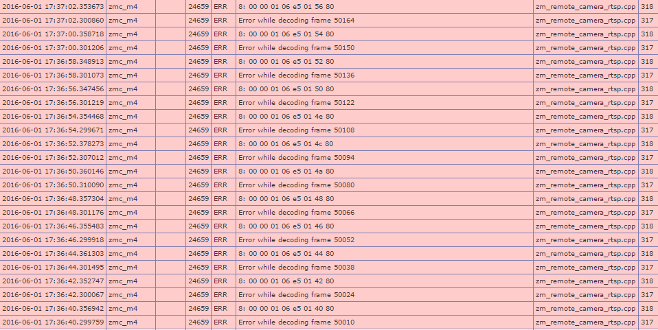

So I installed ZM the other day so I could us my new IP camera. I've installed ZM on my Ubuntu 14.04 server and used nginx instead of apache (using the example nginx config). everything seem to work fine, I can view the camera fine however, I noticed the log was getting spammed with errors saying 'Error while decoding frame' (screenshot below). I'm using a Sinocam SN-IPC-5033 CSW-WI-UK (Its a 1080p wireless IP camera).
What should I do about this error?

Joined: Wed Jun 01, 2016 5:21 pm
Re: Error while decoding frame [Ubuntu ZM1.29.0]
Post by scubaman »
Hi
I have a similar issue . After the install of 1.29 on ubuntu 16.04 all as fine and then I noticed new events were not always registering in the camera panel but the live feed was fine . The logs shows the decoding frame error entries (see the sample attached) . I have read a few other posts for advice and dropped the FPS down to 7 . Also RTSP is using TCP which I have confirmed via a packet capture
